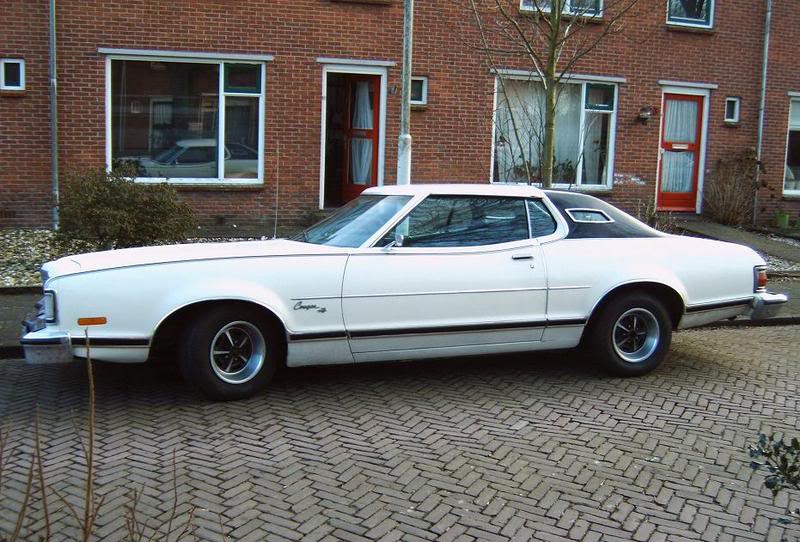

here some pictures Attachment 448
Attachment 449
Attachment 450
you can see they ripped of the vinyl roof and didn''t painted it allong the original lines, not a very big problem for me because when i get it al sorted out, i''m going to get it painted white, the truck garage i work also has a own bodyshop en paintbooth, so can be done cheap.
for the rest the car is rustfree except some surface rust around the edge of the boot lid.

maxfax3 Feb 28, 2009 04:41 PM
Very nice!!! Yes unfortunatley the old gems are getting scarce over here too.. Especially after the past few years.. The scap metal price has been high and alot of restorable but not perfect cars of this era have been scrapped..
