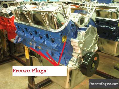

This is eseentually what happens with the freeze plugs.. Over they years they can tend to rust from the inside out.. The same happens to the inside of your engine block, but it's much thicker and better metal so it doesn;t rust though as quick.. While these freeze plugs are rusting sediment and such (mostly old rust from all over the engine) settle at the freeze plugs since they are about the loest point that coolant flows.. All this junk settled at the freeze plugs actualyl helps keep them from leaking, sort of like stop leak.. But once you flush all the crap out there's nothing plugging the little pin holes that have formed in the freeze plugs from rust over the years.. IF they start leaking after you flush it they were pretty much shot anyhow, you just cleaned the dirt out that would have been plugging the holes...

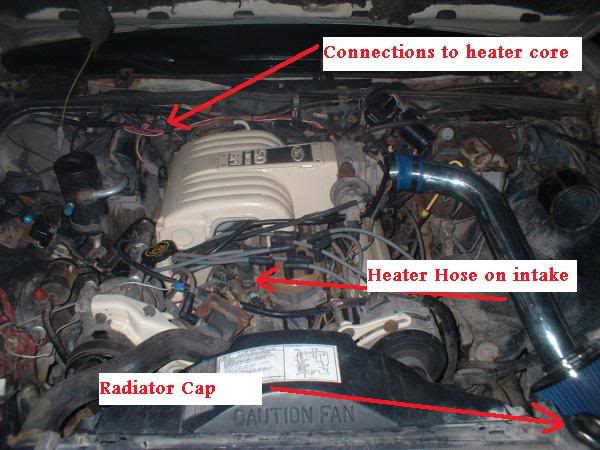

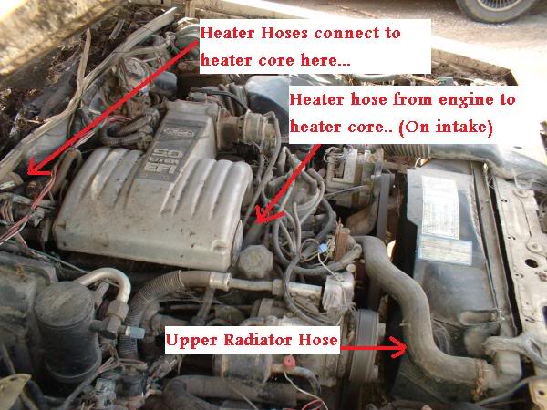

Since my dig cam is being a &%&*@# I stole 87_Crown_Vic's pics and added some labels to give you an idea where to look for heater cose connections..
Attachment 410
Attachment 411

Here's a decent pic of freeze plug locations...
Attachment 409
