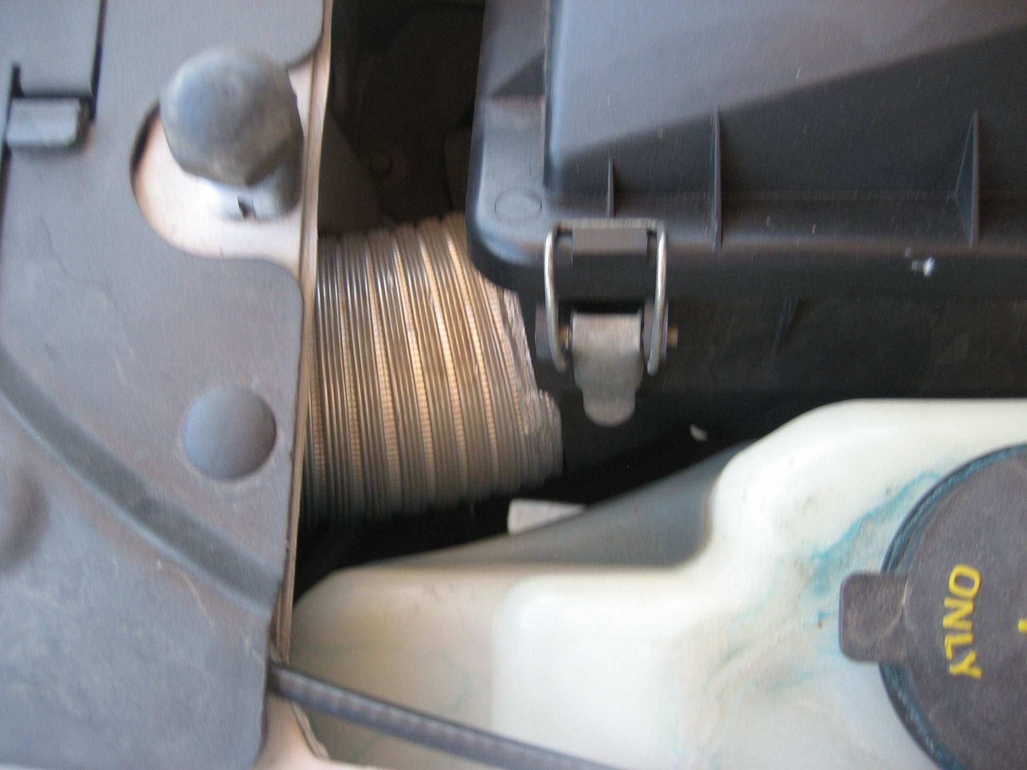

Snorkle Removed. Cold Air From Behind Headlight. K&N Flat Filter.

K&N Air Filter in stock air box, with snorkle removed -- replaced with 3" i.d. aluminum ducting.
