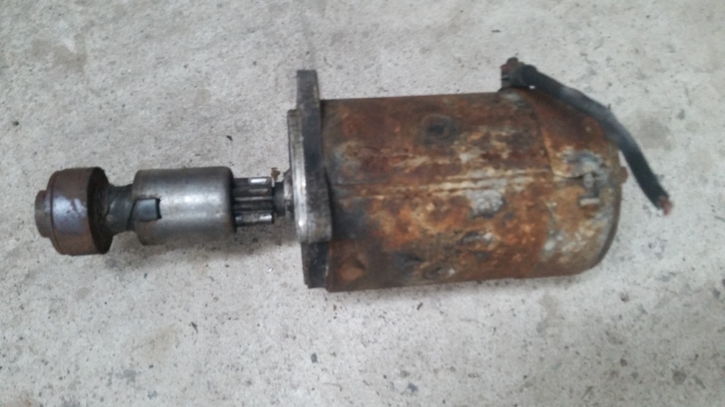

2 Attachment(s)
No, here are some pics.
Thx, Mike |
