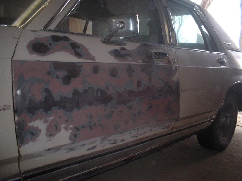

here are pictures... will have plenty more...

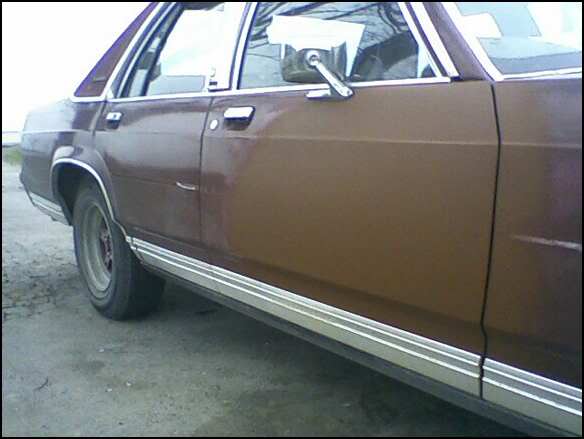

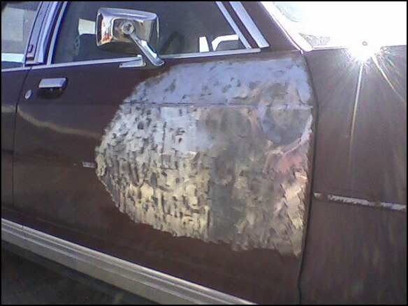

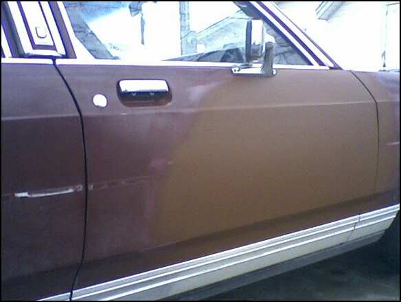

look at dent in passenger door... and progress being fixed... Attachment 428 Attachment 429 Attachment 430 http://i48.photobucket.com/albums/f2...obodywork2.jpg Attachment 431 Attachment 432 |
dont worry... the dent wasnt all filled in with bondo...
we used a stud welder to weld studs to the deeper dents, attached slide hammer for my girlfriend to pull steady while i worked out the dent stretching it back into place and getting rid of high spots... all the work was done from outside the door. i got the door pretty much knocked back in shape and only used the bondo stuff for filling the smaller stuff where metal quite wasnt right. personally, i dont think it looks too bad trying to mess with the bodyline was a pain though... |

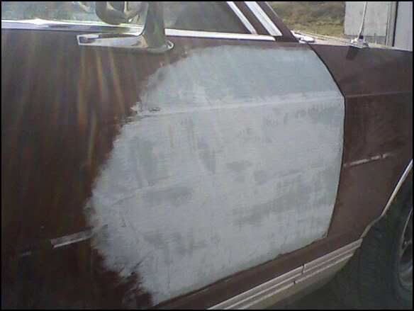

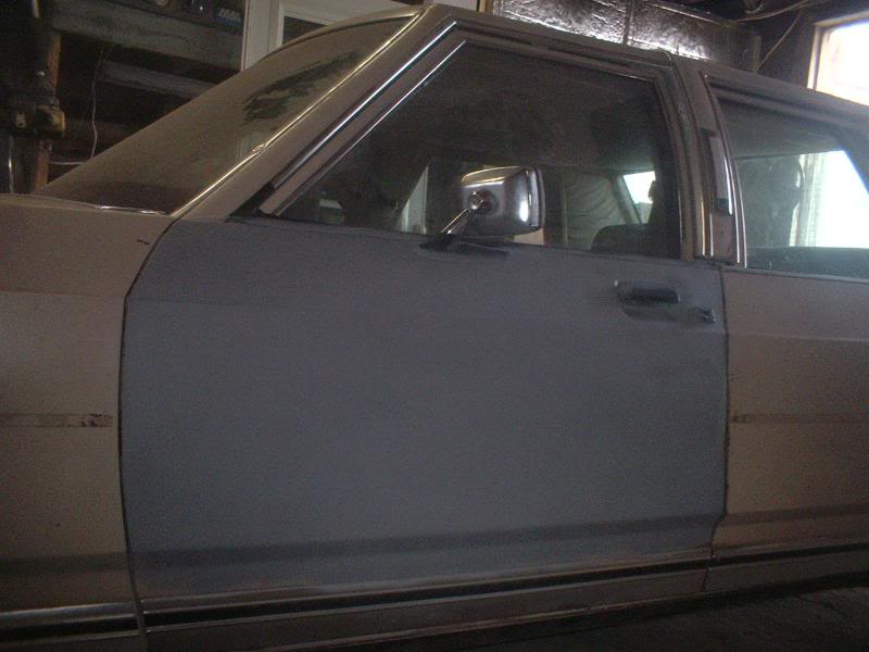

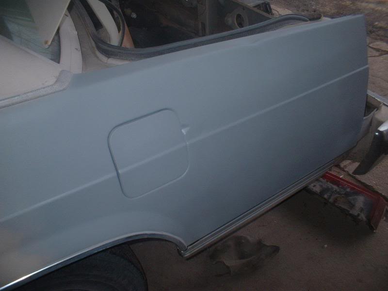

4 Attachment(s)

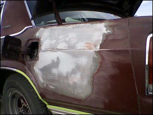

here are more pictures of the driver door and driver rear quarter.... i need to get a picture of driver door primed... it got dark out and unable for photo opportunity.
Attachment 424 Attachment 425 Attachment 426 Attachment 427 |

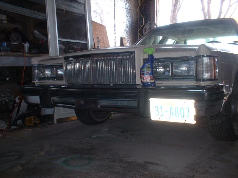

i recently did some body work on my 1987 Grand Marquis... i also did a bumper swap to have the slotted type opposed to the solid faced. now all i have to do is channel the air flowing in the bumper up to my CAI filter setup

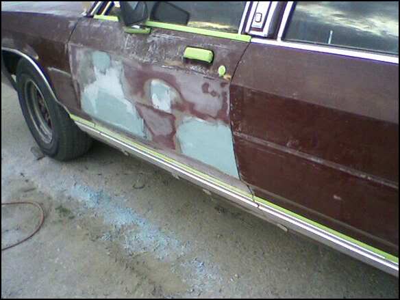

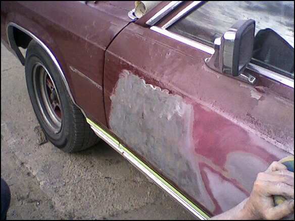

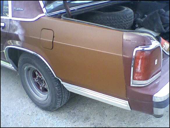

6 Attachment(s)
here are pictures of the progress on my Grand Marquis... forgot that i took some and didnt post ...
Attachment 417 Attachment 418 Attachment 419 Attachment 420 Attachment 421 Attachment 422 |
