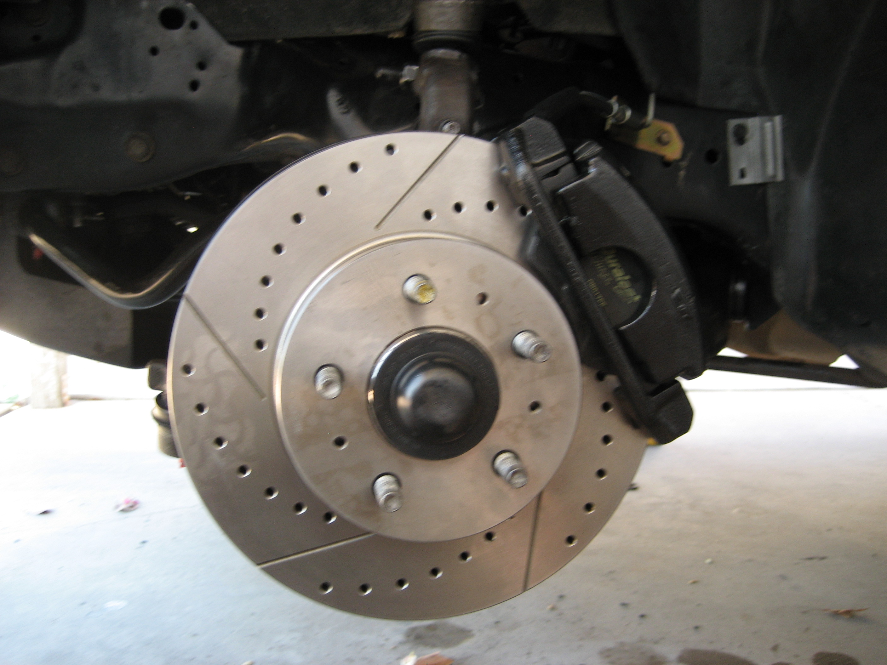

Here is what I did:
Moog Coil Springs (front)
MOOG Ball Joints (Upper & Lower)
MOOG Greaseable End Links
MOOG Idler Arm
MOOG Tie Rod.
MOOG Tie Rod Ends
ADDCO 1 1/4th" Front Sway Bar
Energy Suspension Control Arm Bushings.
Energy Suspension Sway Bar Bushings
Energy Suspension Spring Isolators
Motorcraft Wheel Bearing/Hubs
.Motorcraft Police Brake Pads
ACDelco Drilled & Slotted Brake Rotors
Eclipse Brake Calipers
Centric Brake Hoses
Dot 4 Brake Fluid
KYB Police Upgrade Shocks
I did the rear suspension, too --
KYB Shocks
ADDCO 1'' diameter Sway Bar
Energy Suspension End Link Kit.
Eclipse Calipers
ACDelco Drilled & Slotted Rotors.
Police Upgrade Brake Pads.
Centric Brake Hoses
DOT 4 Brake Fluid

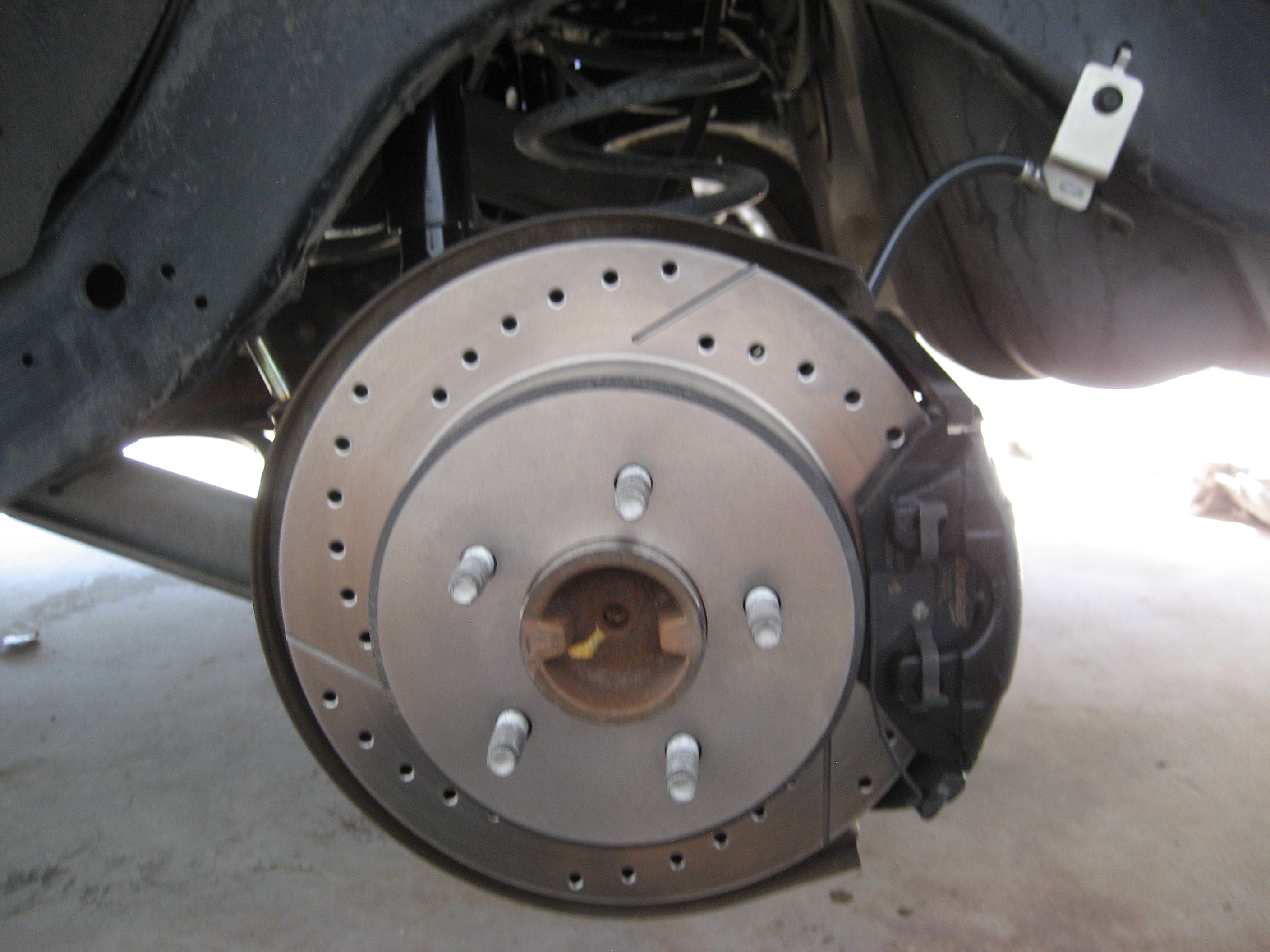

The '95 MERC was restored as a long-distance, high-speed touring sedan that's capable of handling the Rocky Mountains and the Southwest deserts, regardless of temperature extremes.
