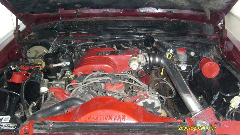

86-91 Crown Victoria, Grand Marquis, and Town Car can have a CAI installed and not have to be super custom. a look at my signature and the picture below of my girlfriends 1989 Crown Vic is a good idea for those who have a 5.0 Panther platform. all it is is a CAI from ebay costing between $30 and $40. it is actually for a 1990-1993 Acura Integra, but fits great after you hacksaw off 6-8 inches off each end.
Attachment 471 |
hell, thats a damn good idea. thanks bo.
i know the setup in pictures i posted make engine sound different along with a hiss sound from air getting sucked in. really noticeable when you tap and release quick on the gas sitting in driver seat with window down.... alomost a sound of a snake hiss almost
