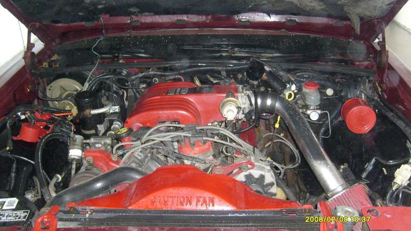

86-91 Crown Victoria, Grand Marquis, and Town Car can have a CAI installed and not have to be super custom. a look at my signature and the picture below of my girlfriends 1989 Crown Vic is a good idea for those who have a 5.0 Panther platform. all it is is a CAI from ebay costing between $30 and $40. it is actually for a 1990-1993 Acura Integra, but fits great after you hacksaw off 6-8 inches off each end.

i know the setup in pictures i posted make engine sound different along with a hiss sound from air getting sucked in. really noticeable when you tap and release quick on the gas sitting in driver seat with window down.... alomost a sound of a snake hiss almost

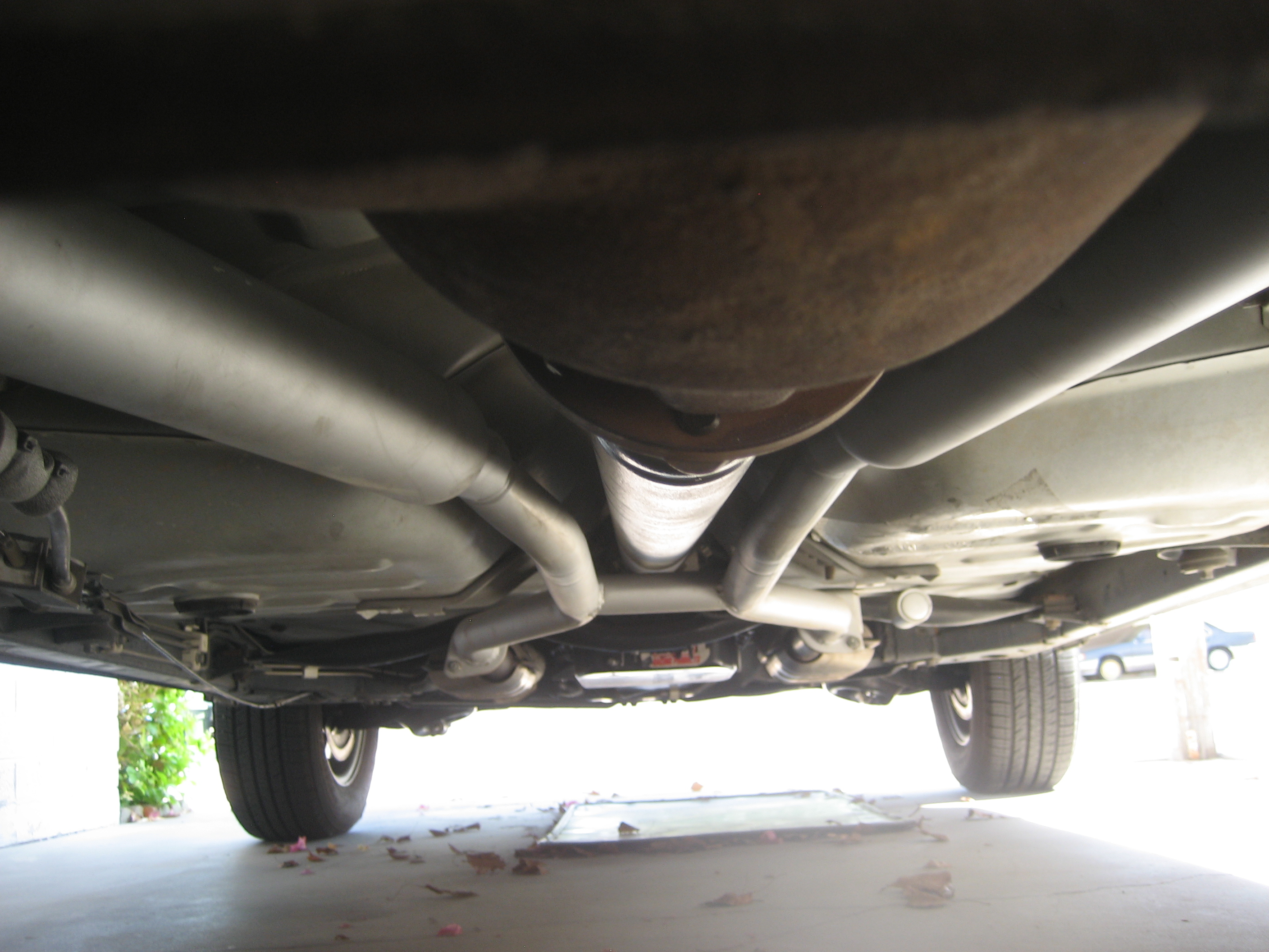

Installed a TAYLOR HELIX Throttle Body Spacer (#46015, '93-'95 4.6 liter) on the 95 MERC.
Followed instructions carefully, using all parts supplied.
I keep close records of the fuel mileage, recording all fuel used to two(2) decimal places (00.00).
CONCLUSION, after 2,000 miles of use:
NO increase in fuel mileage.
NO measurable increase in power or performance (checked with G-Tech Pro).
My observations show that a throttle-body spacer is of NO USE on a Sequential Port Fuel Injection (what the 4.6 liter engine has) system, as the fuel-air ratio is computer-controlled, and the size/type of fuel injector is a bigger factor than intake-air "turbulence", or lack of same.
After testing and research, I now have an absolutely beautiful, CNC-machined paper-weight to remind me of my gullibility.
HOWEVER, I have used spacers between the carburetor and manifold on several engines, and with both 2 bbl. and 4 bbl. carbs -- with varying results, some positive, but mostly negative.
All things considered, I would advise against the use of spacers for street use.
As for HEADERS on a Grand Marquis !?? You've GOT to be kidding !!
Picture shows dual exhaust on a '95 Grand Marquis -- Walker H-Pipe, 2" Magnaflow Glasspacks, Walker tailpipes. Added 24 Horsepower over the stock single exhaust, checked with G-Tech Pro.
