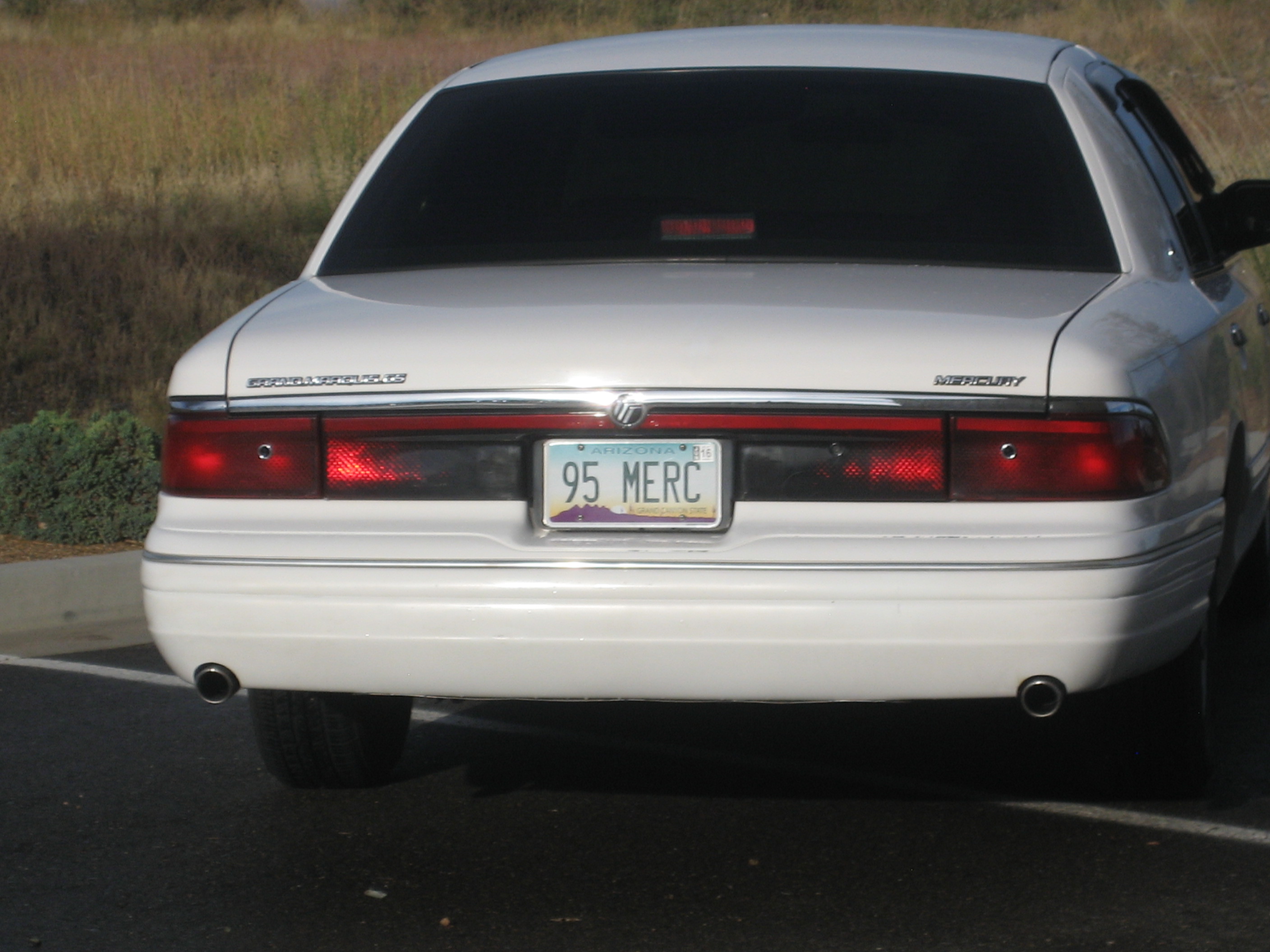

Default '95-'97 Grand Marquis Dual Exhaust

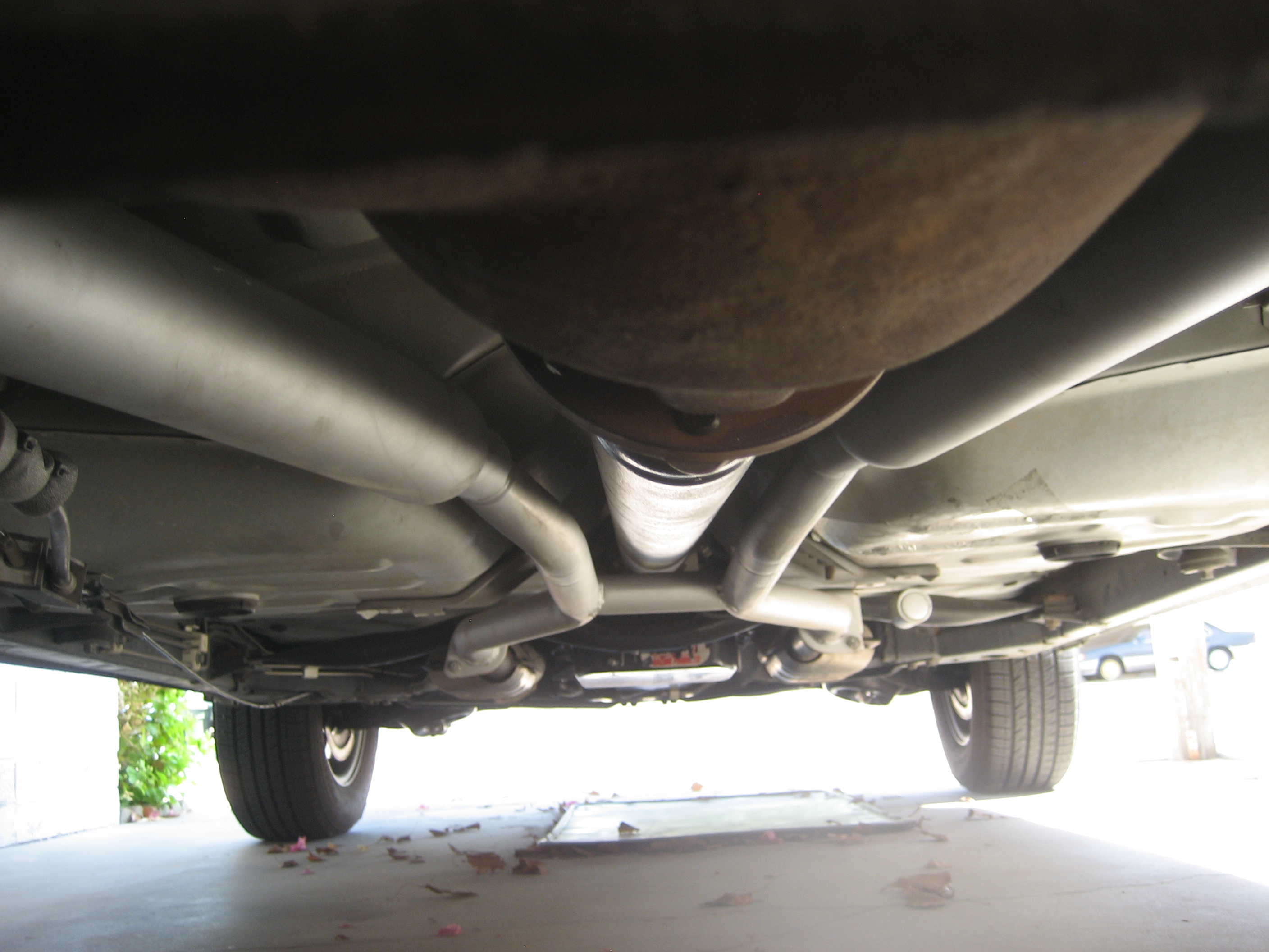

What You'll Need For The '95-'97 Grand Marquis Dual Exhaust.
Walker H-Pipe -- (Part #40383) NOTE: When installing H-Pipe, use stainless steel bolts, nuts, and lock washers.
MagnaFlow 2" Glasspacks -- (Part#18134)
Walker Tailpipes -- (Part #46761 Right -passengers side).
(Part #46789 Left - driver's side)
Stainless Steel, slant-cut tips. (Superior Part# 28-6201).
When building your dual exhaust system, DO NOT go bigger than 2" outside diameter - Torque and Power will DECREASE !!
I got the exhaust system parts from Amazon.com, clamped it up to check for fit, and had the system welded up at "MufflerMasters", Avondale, AZ.

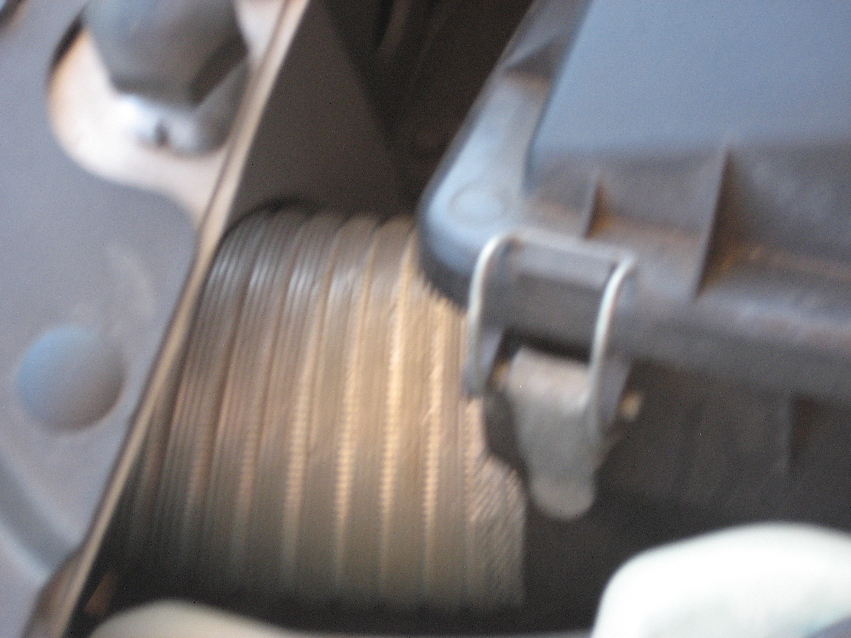

1.- Home-Made Cold Air Intake with K&N Air Filter - (Part #33-2272). NOTE: The "flat" filter has more surface area
than the conical filters used on those aftermarket CAIs - AND they're MUCH easier to clean and oil properly !!
2.- Mallory Adjustable Fuel Pressure Regulator @ 35 psi, (hot idle) with all hoses connected and accessories turned OFF.
3.- Walker-MagnaFlow dual exhaust.
4.- Stainless steel exhaust tips.
5.- B&M Shift Improver Kit - (Part #40264)
The whole performance package was less than $300, including the CAI, Dual Exhaust, and the B&M Shift Kit
Results: Quarter Mile @ 16.2 -- 88 mph -- 1100' elevation, 94 F outside temp.

Default Conversion to Duals
Originally Posted by MississippiMark
Can you reuse your current muffler and tailpipe in a dual exhaust conversion? Would it make any difference if the two mufflers were not the same?
Re-using the stock muffler and tailpipe on a dual exhaust conversion is NOT a good idea -- and YES, it WILL make a difference if the mufflers are not the same !!
The whole purpose of a dual exhaust conversion is to have a BALANCED, high-flow system.
Both mufflers should be EXACTLY the same part number for best results.
I used:
Walker H-Pipe; MagnaFlow 2" Glasspacks; Walker Tailpipes.
