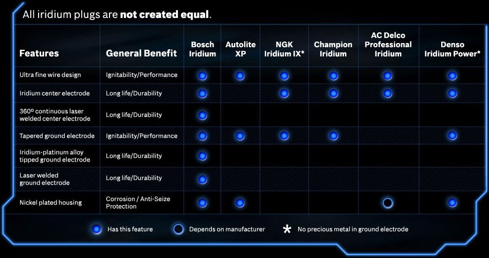

Left-click on the chart below for a larger view.
