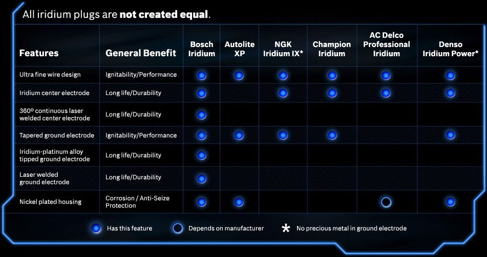

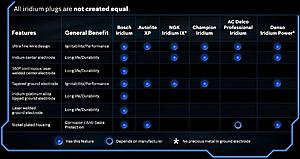

The MotorCraft plugs were a good choice -- IF the proper type was chosen. The Factory Shop Manual specifies that ONLY the DOUBLE-PLATINUM type be used, as the SINGLE-PLATINUM type will fail after 30,000 - 40,000 miles.
I've experimented with several different plug brands, and found the best all-around performance and fuel mileage comes from the BOSCH DOUBLE-IRIDIUM #9605, which is best for the '92-'95 models, and the #9606 is best for the later years.
