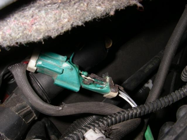

I think this explains it. The connector must have rattled loose and gotten in contact with the exhaust. It explains both the smell and behaviour.
Now the problem will be to get the other side, (vehicle end), of the connector. I'll be replacing the sensor regardless.
BTW, I read somewhere that the upstream sensors should be replaced in pairs. Anyone care to comment on that? Since the car has 160K miles on it it's probably time for it anyway.
