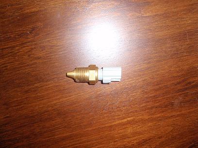

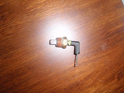

The sensor I pulled out of it has a single wire running out of it, going straight down into a harness (its really crampt so i think thats where its running) and i can see where the wire has been cut and heat shrunk to a new wire running to the sensor. Well, everywhere I went to buy a new sensor is telling me that the one I pulled out is not a match for the engine, all the replacements they show have a 2 prong plug, and my wiring should have a matching plug on the end, which it doesn't. So, whats the best way to approach this? I don't know how to make a (and connect) a 2 prong female plug to a single wire, so that I can then install the new sensor.

I have pictures of the old and new sensor if they would help.

I would try cleaning the old one to start with but it coule be a swap to get a better read if you really wanna change it it shouldn't be overly difficult just trace the wire thats there and find the old wires from the original sensor, its gonna be there somewhere, guaranteed. then just splice some wires into it and get a new connector.
