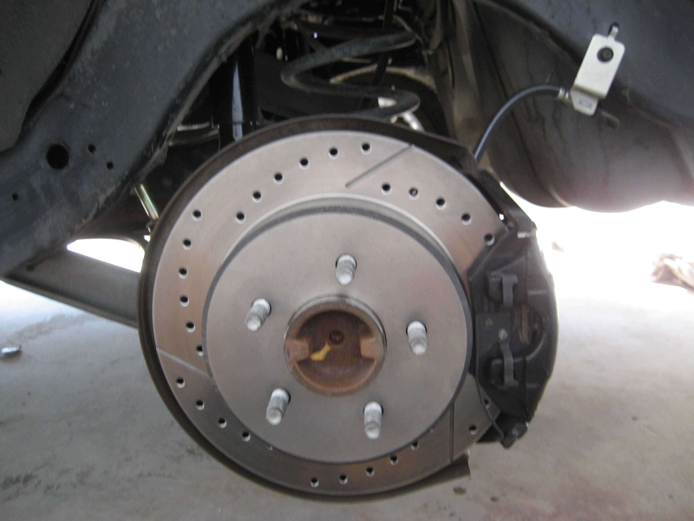

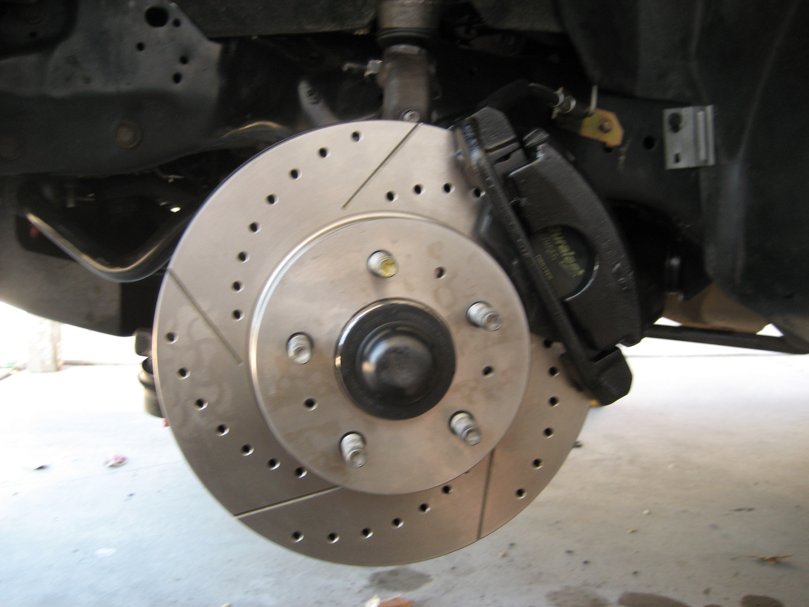

I'm running a non-ABS system, with some modifications:
1. Eclipse brake calipers (NAPA) (front and rear)
2. ACDelco drilled and slotted rotors. (front and rear)
3. Centric brake hoses. (front and rear)
4. Motorcraft Severe Service brake pads -- SDBR678 (front) -- SD107-B (rear)
5. D.O.T. 4 Brake fluid.
System as installed on '95 Grand Marquis delivers straight, smooth stops under heavy use during mountain driving, city traffic, and long distances at high-speed.
