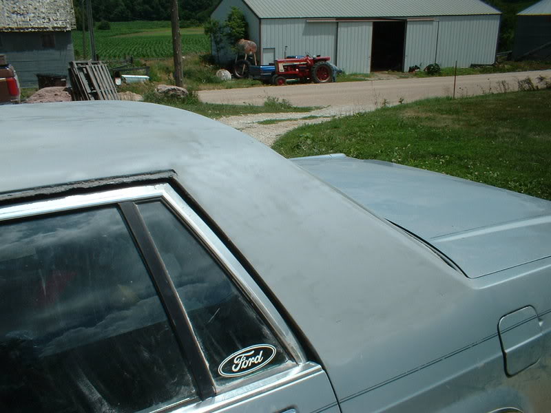

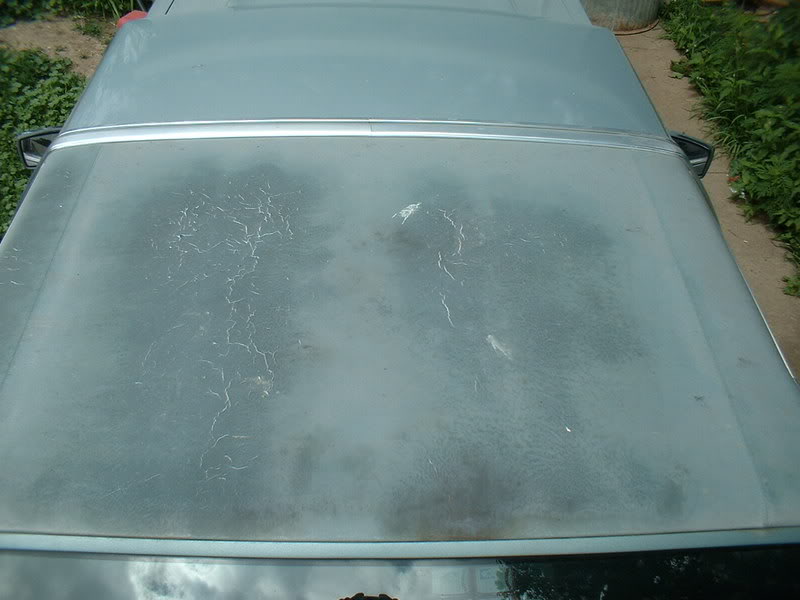

hey there guys i have a 1989 grand marquis now im not a big fan of that vinyl roof any way i can take it off i know people have done it but do you have a step by step guide or some thing that would help me out thanks

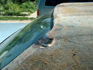

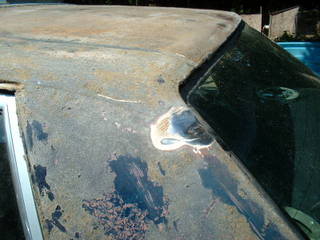

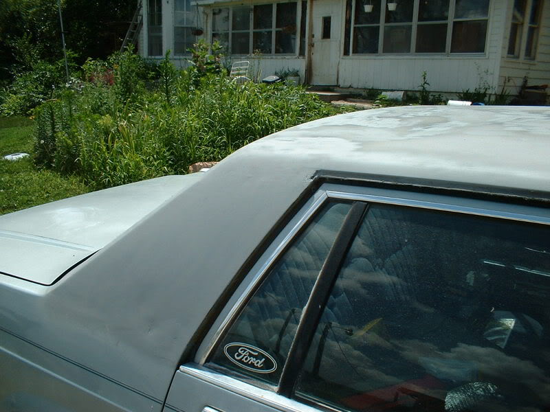

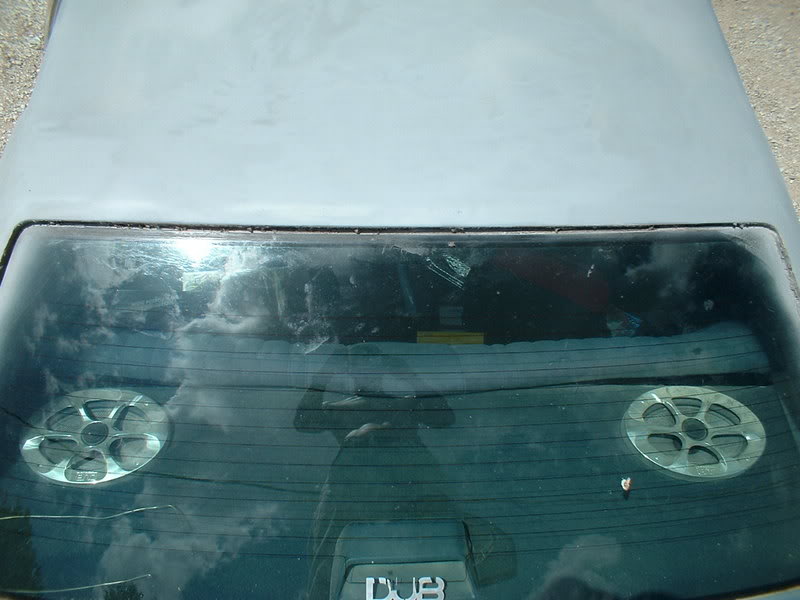

ummmm... depends on the type of vinyl roof you have... they made 3 types of vinyl roof setups on the cars. there was the big window rear, coach window rear and full top vinyl. the last 2 you problay wouldnt wanna mess with the vinyl since you would need new rear glass. the last 2 options i mentioned have a fiberglass shell that extends the roof line and surrounds the glass and is different than a more standard big rear window. trim removal would consist of removing headliner, rear sail panels, and b pillar accessories. you will need access to the nuts and such holding the trim to the roof. if you have questions, ask, i have removed a vinyl roof from a standard rear window type, but fiberglass small windowed ones are a bit more of a pain. to get all the adhesive off you will need aircraft stripper. the rear seams where roof meets the sides arent filled in all to great either since the seams just get covered by the vinyl from the factory. below are some pictures i took during my vinyl removal.

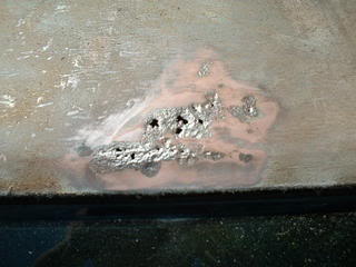

below is a picture of some rust that was hiding under the vinyl... i knew there was rust from how it was turning the vinyl orange over the rear window.

here are pics of the top already been stripped, sanded, and primed.

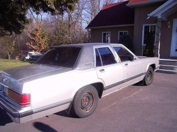

i have the half roof vinyl with side light where are you at by the way CA or US
Old Mar 28, 2009 | 12:13 PM
ok... you dont have the coach rear window with the fiberglass under the vinyl. you have the large window so it will be a lil better for removal like i pictured. you will need a screw driver for door trim removal where vinyl meets the door areas, and be careful with rear window trim, it tends to bend when looked at funny. the side interior pieces need removed by rear dash to access nuts holding side trim on and same with ceiling in the car. the side lights on the car are easily removed by popping the chrome pieces off above and blow the plastic ligh and then it is held with 2 screws. it isnt that hard to do, but the prep work is worst. you will need a couple crappy brushes and a can or 2 of aircraft stripper to get the adhesive crap off the roof. after brushing the stripper on the roof, let it sit for a lil bit and go back with putty knife and trash can to scrape and throw away the stuff being removed. your picture of the car posted will be pretty much like the photos above ofr some of the stuff. dont be surprised if you find rust or bad seams where the factory didnt care because it was just getting covered....
