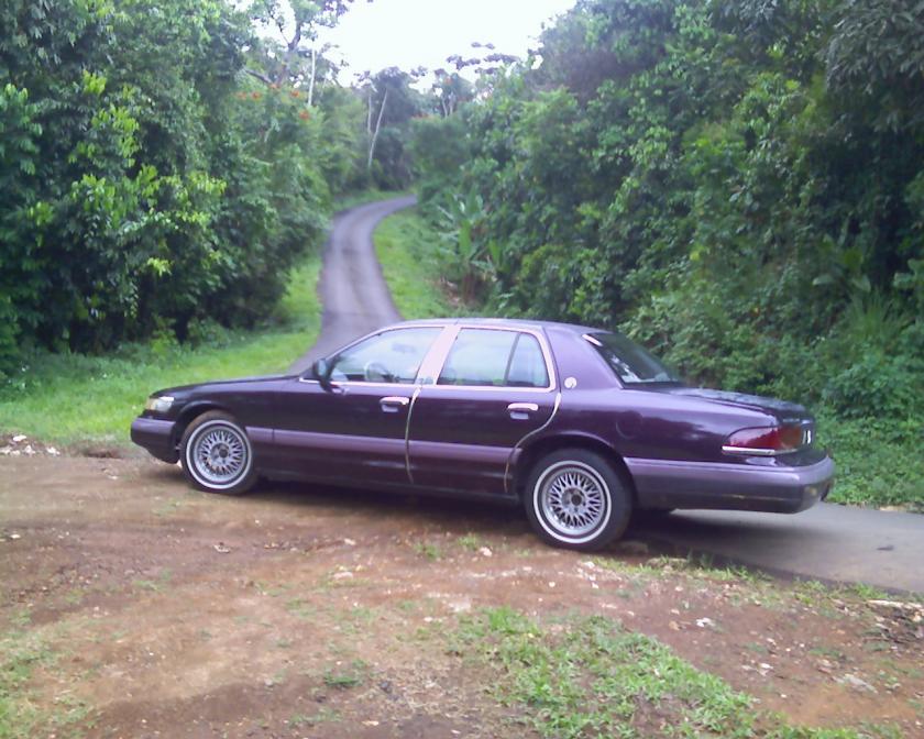

Hi to everybody Im from Puerto Rico,Im new to this forum and I have a real nasty problem.The oil pan of my engine is with water.I think is a blown gasket but I read in a book that the car have TTY bolts and that have to replace them.Is that true and I wonder if is better buy an other engine or replace the gasket because is not like the old V8 engines with the camshaft in the middle of the engine this engine is SOHC so is a lot difficult.Is not a make it yourselt thing.My car is not new but is the best car I ever have because is big is not like have a Mazda or Toyota piece of crap and really I dont want it to waste.Any help or suggestion at all is well appreciated.Thank you very much

My car is a 1992 Marquis with a 1995 engine on it so I really dont know the mileage of the engine because I buy it like that but I will try to explain in details what happen.The car was working perfect but it start to shake like when the spark plugs are gone.I check the cables and there were two cables with corrotion(not one year since i bought them) so I buy new cables.I instaled them,run the car,and noticed that the temp was in the middle(thats a new on my car)so I flush the radiator,install new spark plugs add coolant and run the car,and the car with the same shaking and the temp get in the middle again so I check the cooland reservior and there was no coolant at all so I add 1 gallon of water,2 gallon of water and I thought there is something wrong because is to much water and when I check the oil there was the water mixed with the oil.What is strange to me is how fast the water gets in the oil pan thats why Im not sure about whats wrong with the car.I haven't use my car since that day so is not like the car run with that mixture in it.Tomorrow Im going to check the oil cooler(if I find it)and the other thing close to the oil filter.Thank you very much for your help and if you think you know whats wrong with it please let me know.
