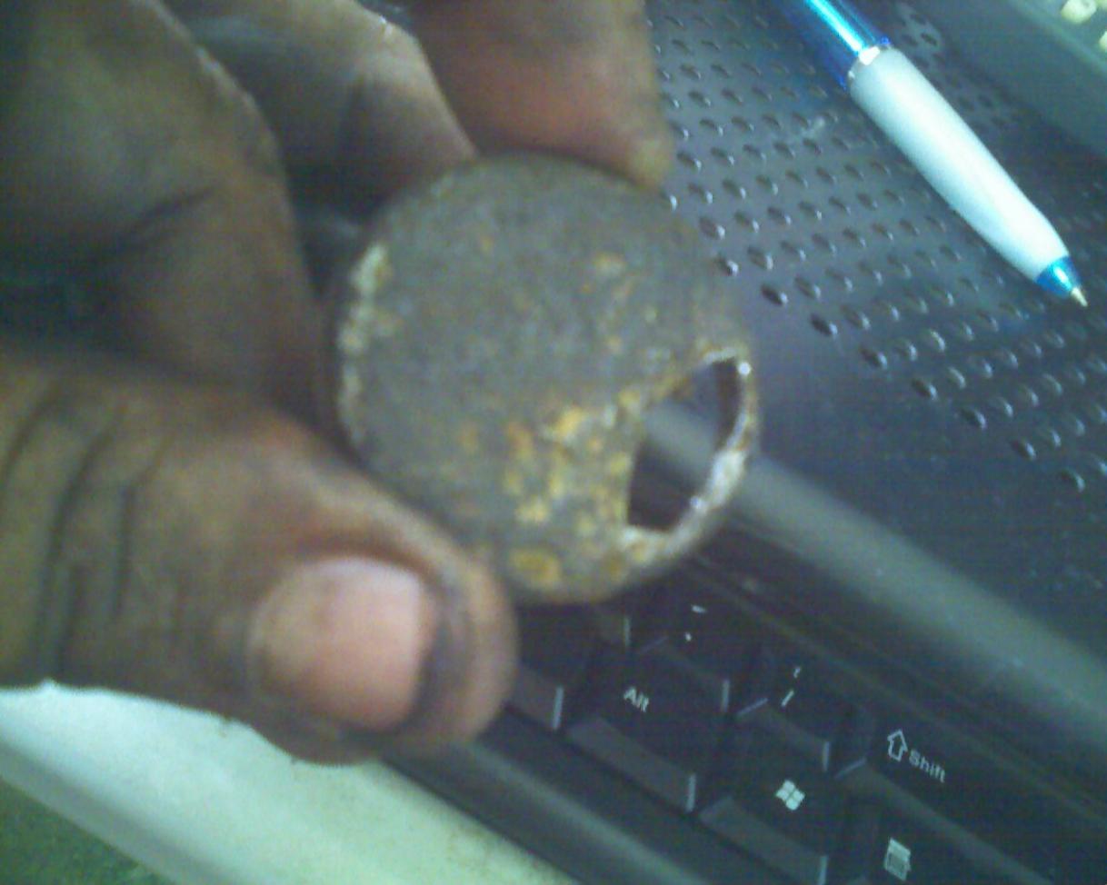

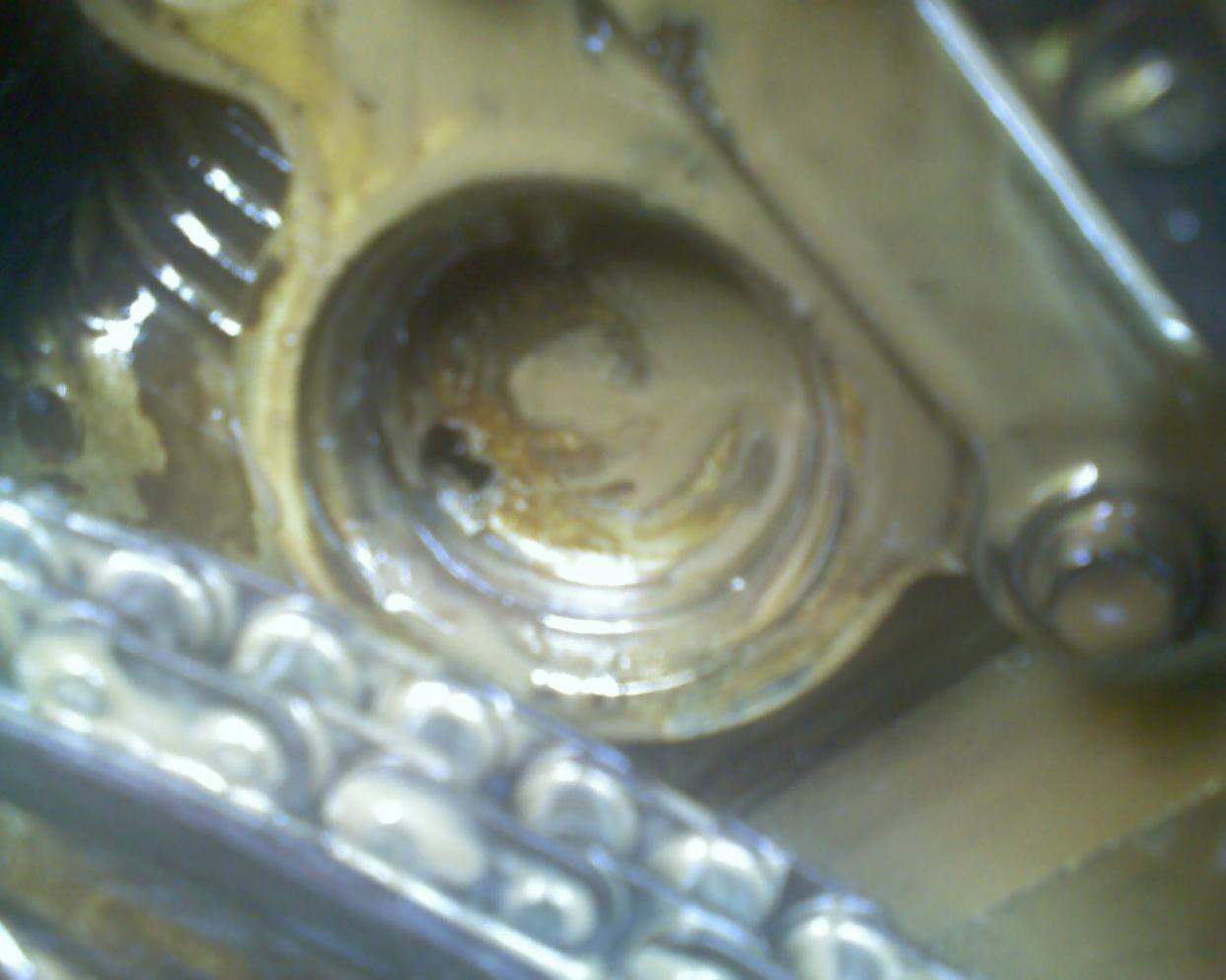

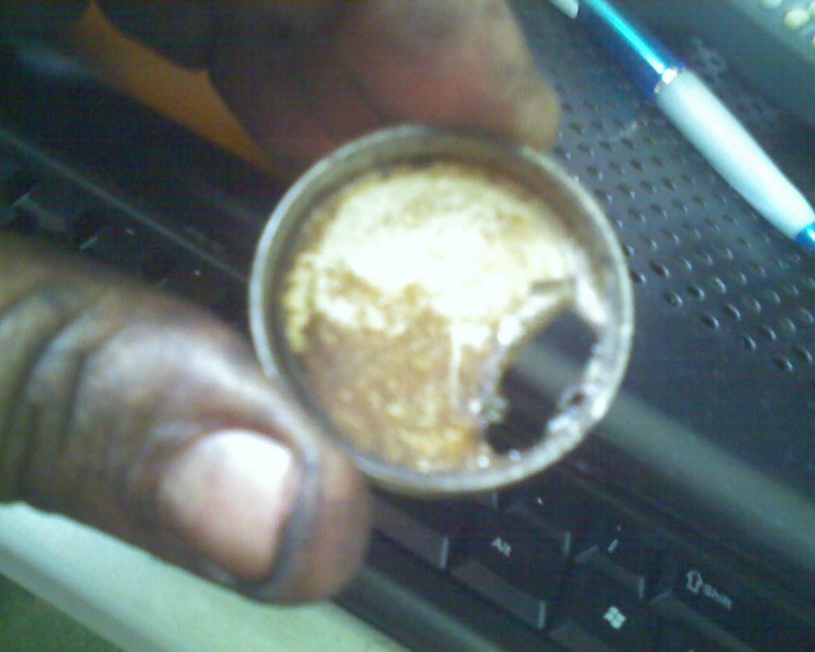

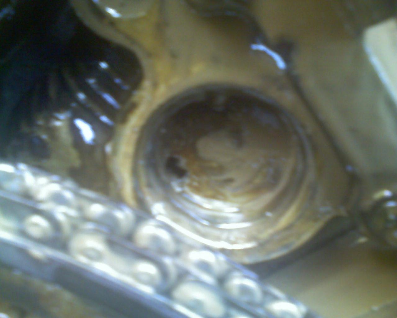

Look what I found when I remove the timing chain cover... Thats why so many water in the crankcase...

Old Jun 22, 2009 | 02:47 PM
  #8
yeah... that my friends is a HOLE!
wow.

maxfax3's Avatar
Joined: Nov 2008
Posts: 232
Indeed it is!!! Looks like you might have a slighly easier fix than you thought..... I've never even taken notice to that particular freeze plug there... I have to wonder how many of these cars ended up a a junkyard for a "blown head gasket" because of that right there...

Ramon0469's Avatar
Joined: May 2009
Posts: 9
Thanks Max for give me the courage to fix my car. I start the engine today and is working fine and the funny thing about it is that the water seal cost 80 cents. The timing chain wasnt damage and You where right about the engine,is not complicated at all. Whats left is to torque the cranckshaft pulley,install the fan,the fan cover and hit the road to see if the engine is working right. Thank you very much fro your help.....
