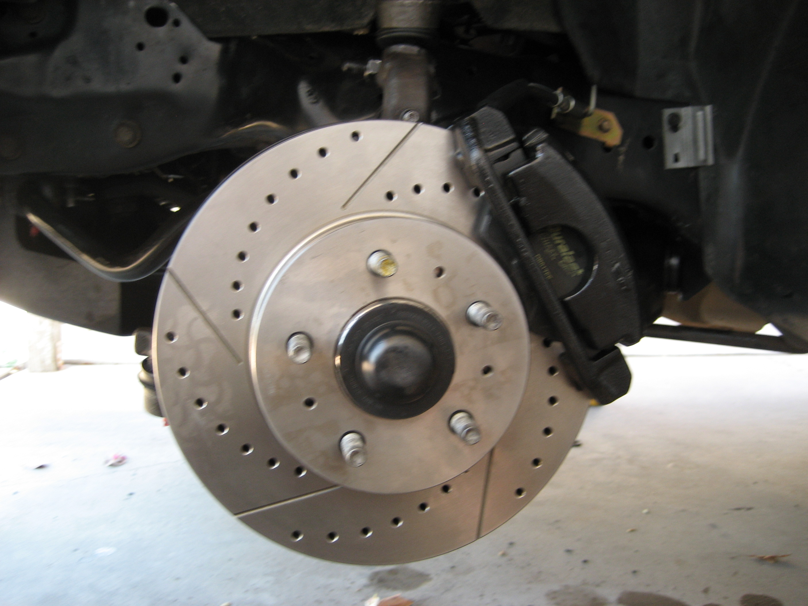

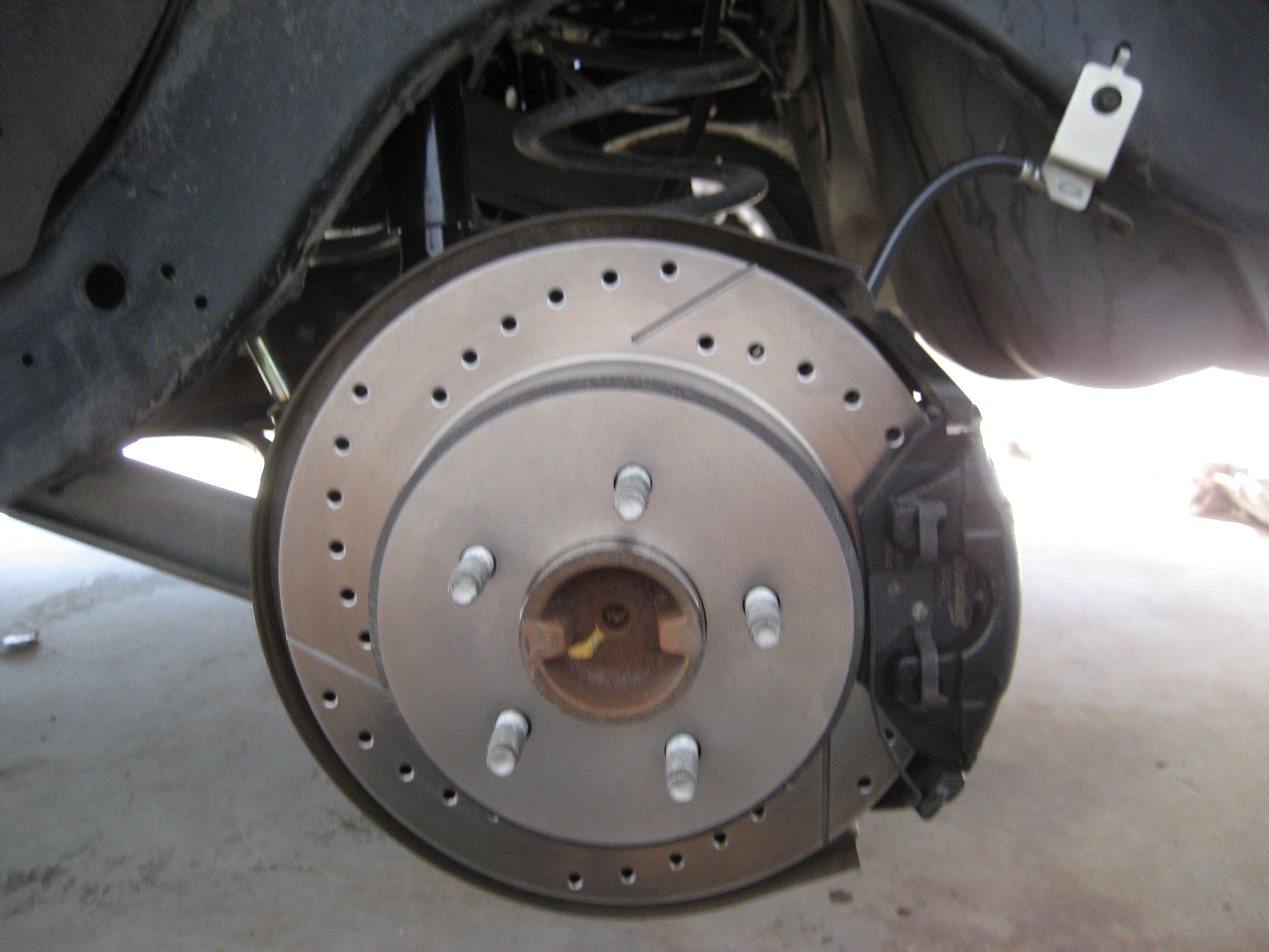

There was a similar problem with my '95 MERC Marquis Restoration. Shudder under braking was bad for YEARS, with many different remedies attempted.
I changed calipers, pads, rotors, hoses, and brake fluid -- even replaced the front wheel hubs -- NOTHING worked, and the brake shudder was pretty scary during high-speed mountain driving.
After several years of frustration, my problem vanished completely, and never returned.
Genuine Motorcraft "Severe Duty" brake pads were installed on all 4 wheels, and the brakes are now EXCELLENT -- quiet, straight, smooth stops, with NO SHUDDER at any speed.
Complete brake system rebuild =
Eclipse Calipers.
AC/Delco Drilled & Slotted Rotors.
Motorcraft Severe-Service Pads.
Centric Hoses.
D.O.T. 4 Brake Fluid.
The brake parts are available at Amazon.com and RockAuto.com -- best prices and home delivery.
Part numbers for YOUR 2000 Marquis:
Front Pads = Motorcraft #BRSD 748
Rear Pads = Motorcraft # BRSD 674
Attached Thumbnails 2000 MGM rear brake issues-left-front.jpg   2000 MGM rear brake issues-right-rear.jpg
