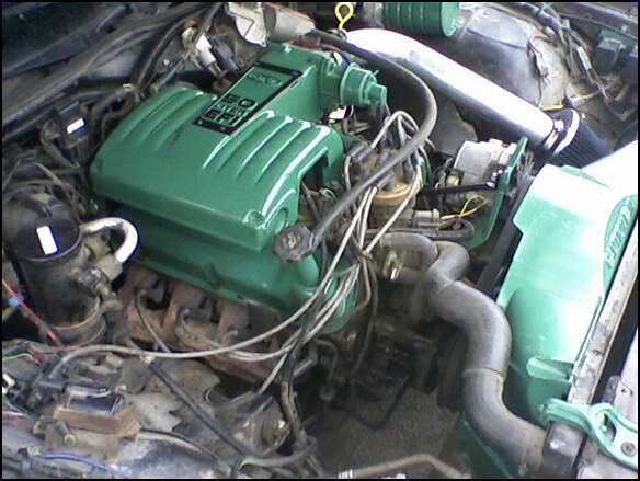

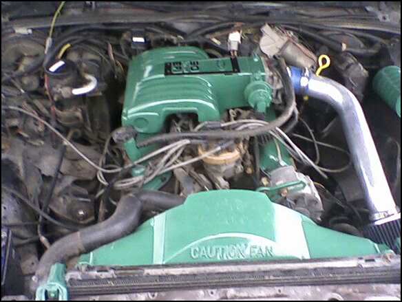

it can be a headache with blocking off vacuum lines and such... especially the ones leading from rear of cylinder heads... all i usually do is track the hose to the smog and plug it with a bolt... the red vac line going to the fender i put a screw in the boot at the multiple hose connector to block it off. as long as you do a tune-up, and oil change and have car hot prior to sniffer check, you should be good. i know many people that also have rammed their cats and still passed with what looked like intact cats. dont use boosters or higher grade fuel before test since it causes higher hydrocarbons. takin a guess you want it lookin like this...

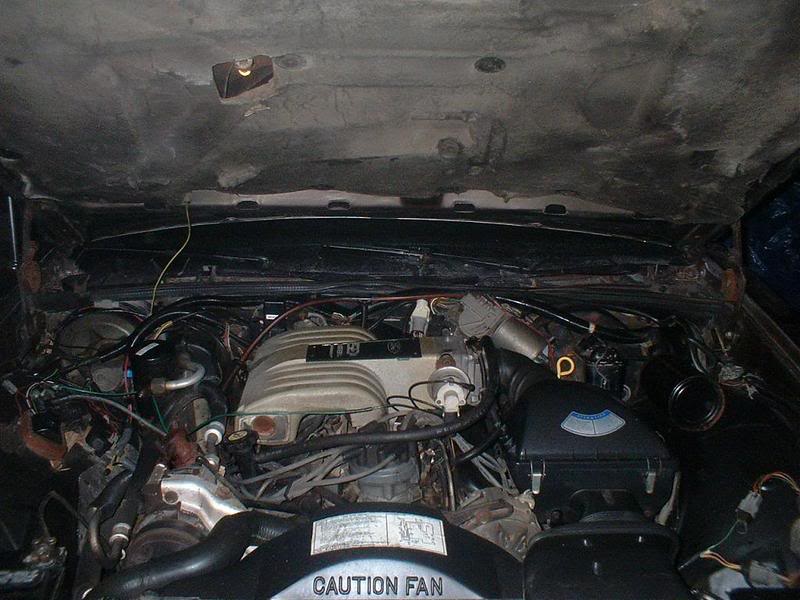

instead of it looking like the stock version???
