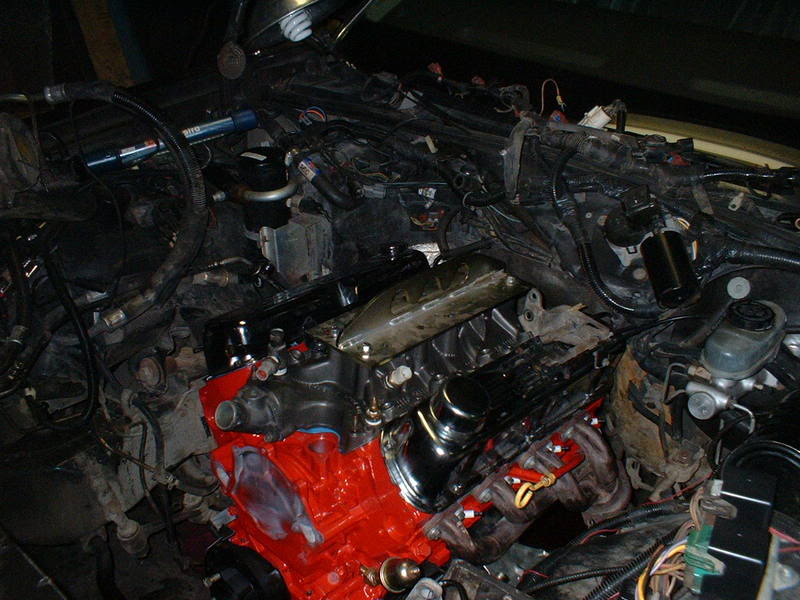

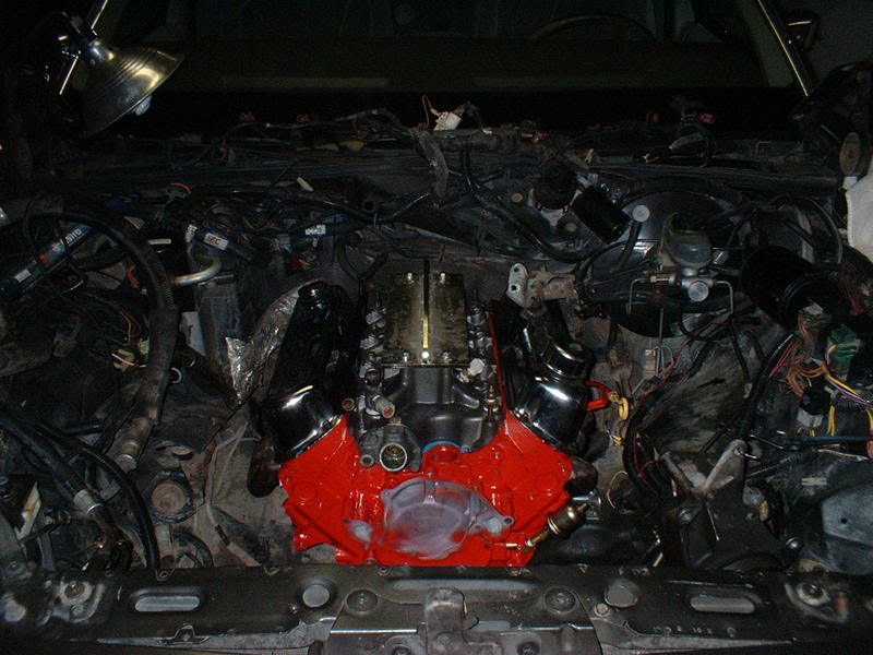

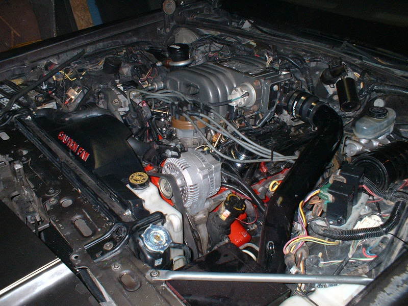

intake swap would require upper and lower from an explorer, and if you go that far, might as well change heads, cam, water pump and timing gears and chain. explorer intakes arent straight line setup like Mark 7 intakes or mustangs. the GT40p heads require headers that are pricier since the spark plugs arent mounted the same as other heads. i helped build and install a HO modified engine. it was a HO block, explorer cam, Mark 7 ECM, shorty headers, HO upper intake, bored EGR, modified HO throttlebody to work like a throotlebody for our cars, thumper heads and stuff.. i am going to be getting a explorer/mountaineer engine with the GT40p heads, EGR spacer and modded throttlebody. my upper and lower intake are going to be better than what is on an exploder set. my upper and lower intakes are typhoon setup that cost $200 plus. i just need a ECM, engine, and shorty headers for my 2 door project car. below are pics of the engine i helped work on and install...
