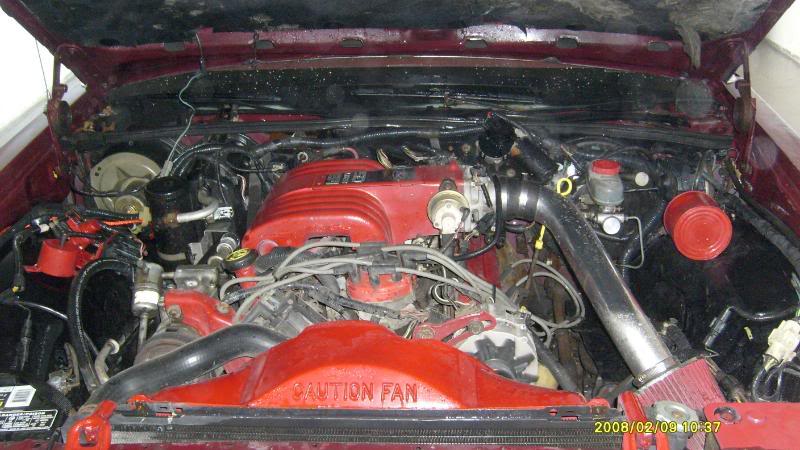

depending on condition of how car was taken care of and what gears are in the rear... my 1987 has a 3.27 trac-lok in the rear and my girlfriends 1989 Crown Vic has 2.73 open...
my 1987 gets close to 20 or so on the highway
her 1989 gets close to 25 on the highway....
of course i have hers modded a lil more than mine at the present time too...
pictures of her car...

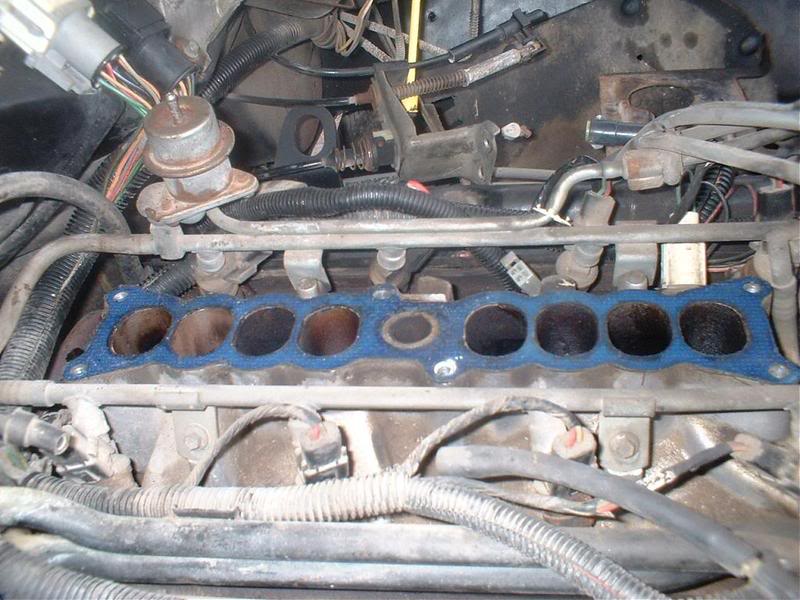

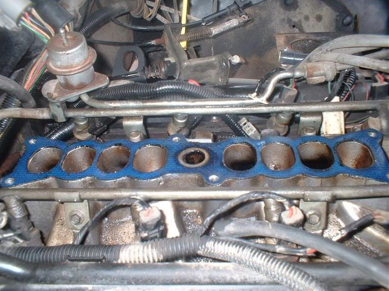

if you get to a junkyard, get a HO upper plenum to replace stock since you will pull that for the valve covers. when it is removed, use some B-12 carb cleaner or something and spray the lower intake channels and clean the crap outta the upper plenum. i use a small wire toothbrush looking thing to clean them up nice. when reassembled it will start hard, and blow black smoke from the crap that just got cleaned out. another thing, get EGR spacer gaskets and where the small hose connects to the return line from heater core, bypass that to the nipple on the lower intake in the back so if the EGR gaskets go bad it doesnt suck coolant into the intake. and also change the PCV and the screen under it since it will be accessible. below are pictures of dirty and cleaned up lower intake the way i described how to do it...

I'm betting on this thing being cruddy even with the frequent oil changes, unless pappy had a lead foot.. What scares me the most is what's under the lower intake.. If it's too crusty the engine just may come out.. I wonder how nasty it would be to shoehorn a 4.6 in there... 87_Crown_Vic, your intake was ALOT cleaner to begin with than alot of them I've seen... I should pull the tube off the throttle body and peek in there to get an idea of how bad it might be..
