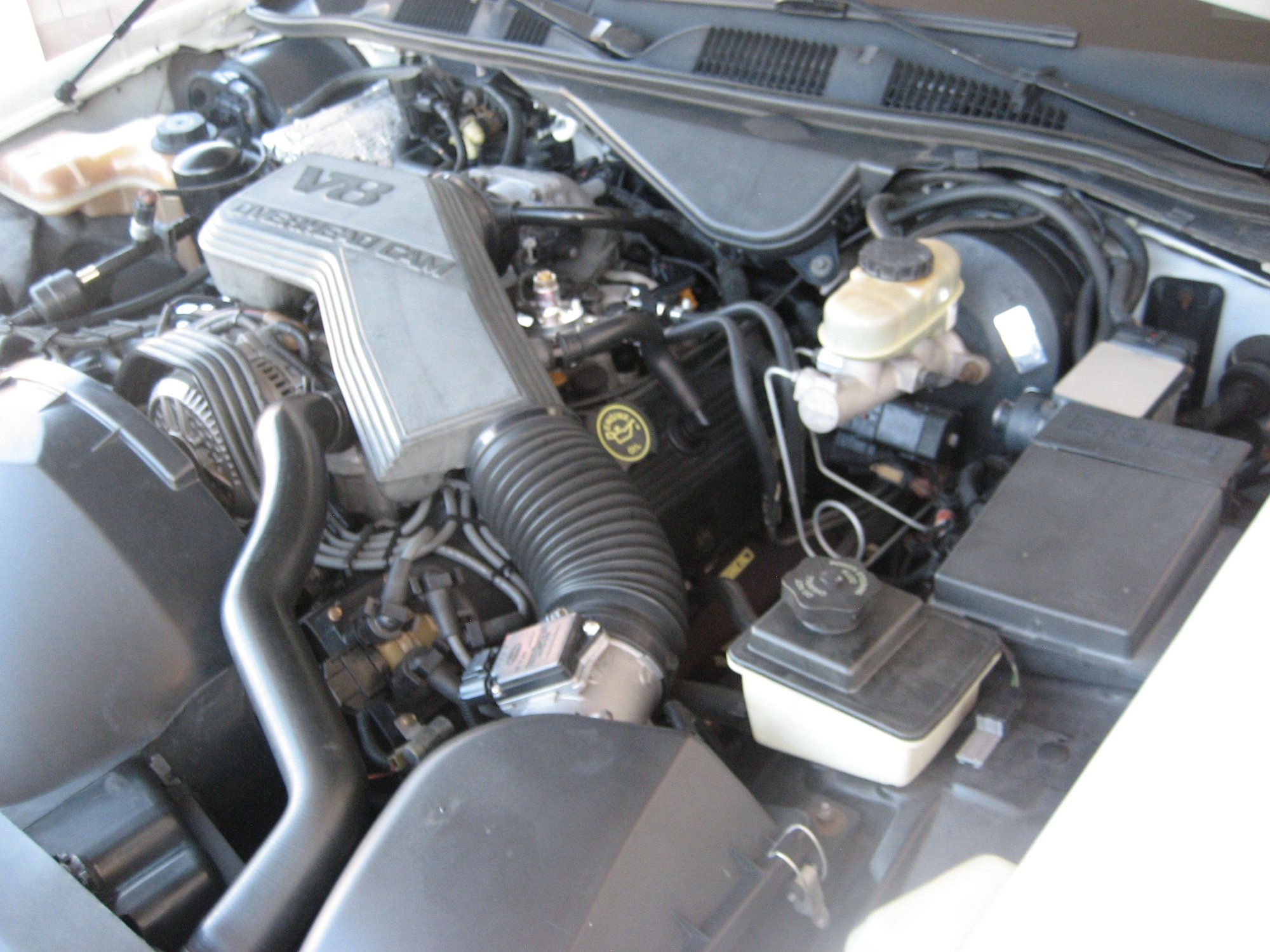

95 MERC Engine Bay
Nice clean engine bay for a '95! So, why the significant discrepancies among the various documentations including your feedback (13, 16, 18, 23)?

Thanks -- That's my 95 MERC Restoration, as seen here: 1995 Grand Marquis Restoration - Mercury Forum - Mercury Enthusiasts Forums
