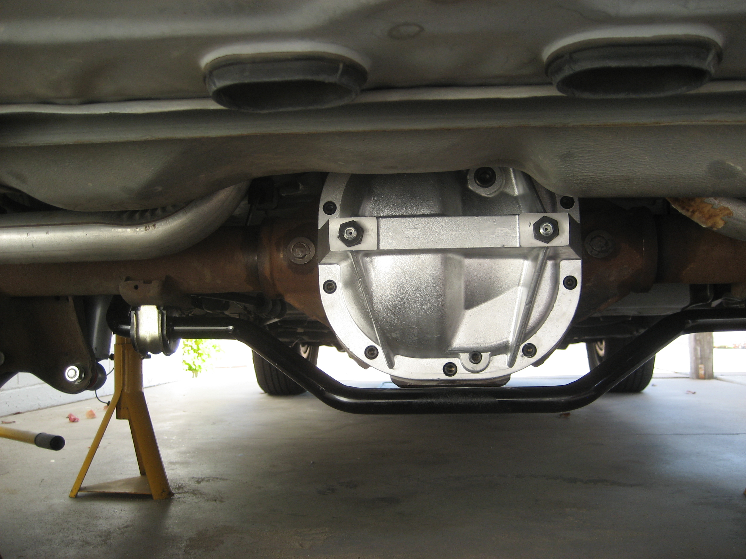

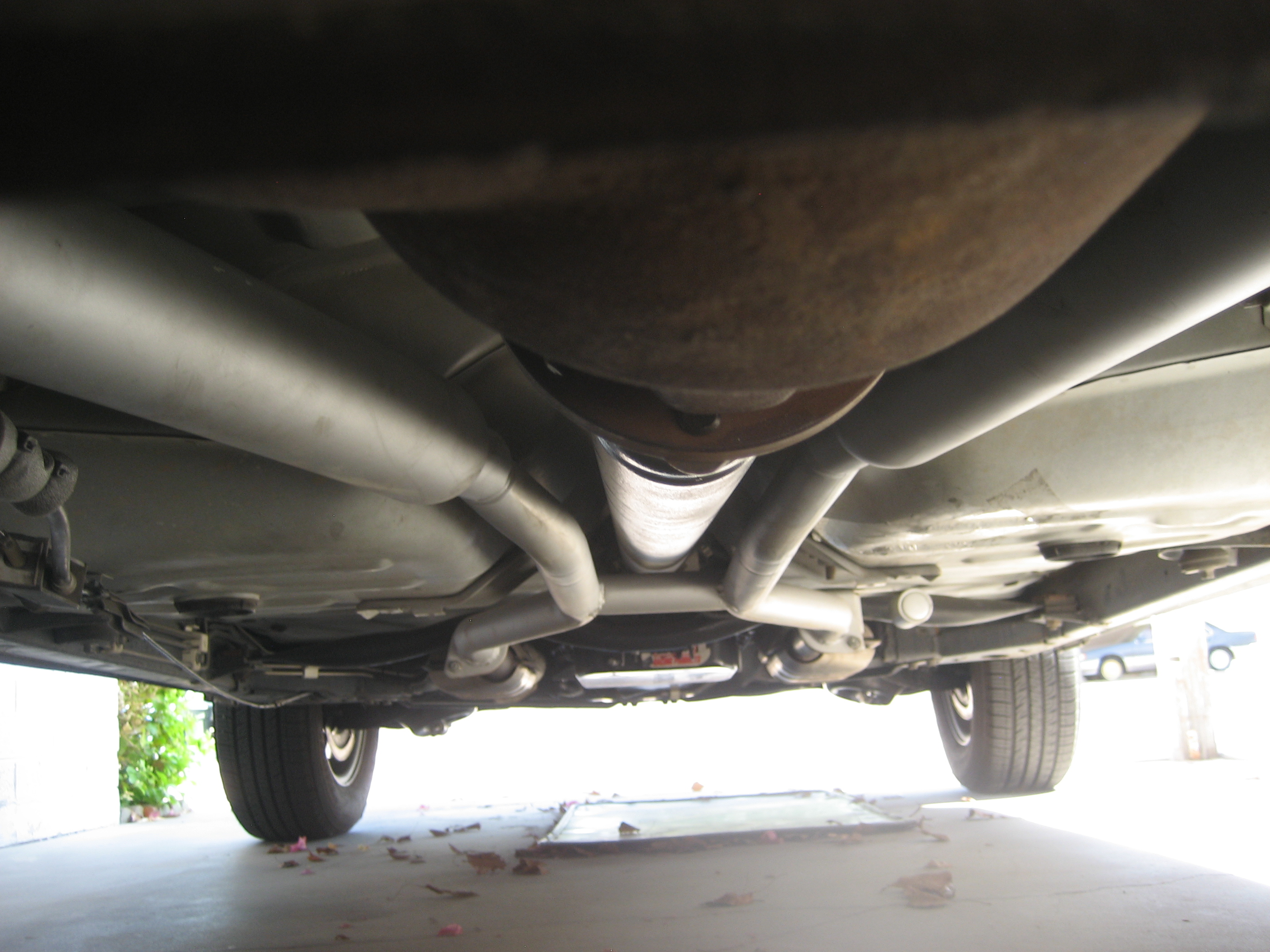

Here's what I did to make my '95 Merc restoration go faster:
1.- Dual exhausts : Walker H-Pipe; Magnaflow 2" glasspacs, Walker tailpipes.
2.- K&N air filter using STOCK air box with snorkel removed- air is ducted from forward of the engine compartment through flexible aluminum clothes dryer pipe.
3.- Mallory adjustable fuel pressure regulator - 35 psi @ warm idle, with vacuum hoses connected and all accessories OFF.
4.- Bosch Double Iridium plugs @ .052
5.- B&M Shift Improver Kit.
Quarter-mile = 16.2 @ 87 mph
I got the parts at Amazon.com and did all the work myself, with the exhaust welded up by "MufflerMasters", Avondale, AZ.
