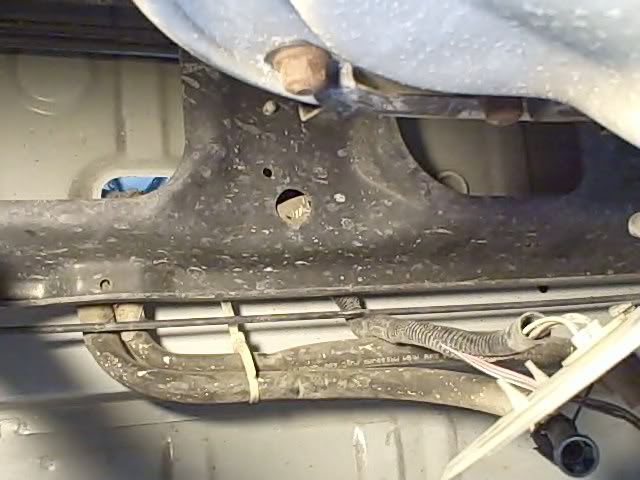

The bigger harness that goes to the fuel pump goes up and into a place that human hands can't go. I've included a pic. PART of that harness goes up into another hole in the trunk that is very near the rear window in the upper cargo area. I can SORT OF see what might be a plug way up behind that black metal that runs the width of th car but there is no way human hands are getting in there. I'd say they routed the wiring wrong and then put that black metal piece in and then installed the shock springs. Yes, that would all have to come out to get to the connector. That being said, I pray to God that the pump is not bad. It if IS bad then I have no alternative but to splice the wires in. There's no damn way I'm dropping the rear suspension to get to a damn plug to for the fuel pump. That's just friggin stupid! The tank is out as you can see. As soon as daughter gets home I'm going to have her try the key again and see if I get it to hum to life.
After I looked at you pictures, I would go to the parts store and look at a new pump & see what the new pump looks like and see if there are any instructions in the box. If not, like you I would be putting a plug connection in line or just splice it.
Another do have the car jack stands under the axle or frame. If you have them under the axle, would moving them from the axle to the frame allowing the axle to drop down give you room to remove the pump from the tank?
so the actual pump itself can not be taken apart from the pump assembly? i thought the pump itself could be separated ... i looked up the parts at O'Reilly auto and it shows it is like what was on my 1992. the fuel pump is the cylinder shaped thing in there with hose connected at top and the screen filter on bottom... unsnap the screen, undo the hose and undo the retaining clamp on the pump and it should come apart. what you are messing with is the entire assembly and not just the pump
