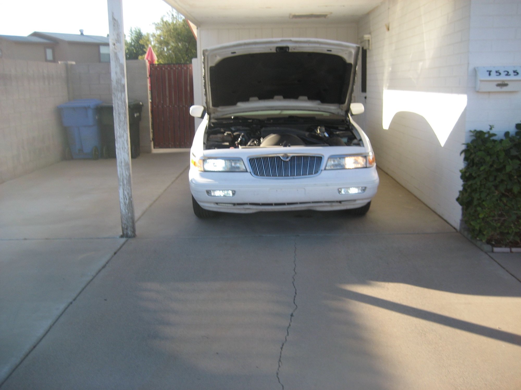

Hello, Rich, and welcome to the Mercury Forums --
Your '96 Marquis has three (3) lights on each side of your front end:
!. - Headlight.
2. - Parking Light.
3. - Marker/Cornering Light.
In the enclosed photo, you will see that the Parking Light is directly BELOW the Headlight.
It is not necessary to remove any other lights in order to replace the Parking Light Bulb.
The bulb is changed by removing the 2 Phillips-head screws that hold the lens in place.
I recommend switching from the standard bulbs to the LED type, as the LEDs make a whiter lite that is visible from a greater distance.
When on trips, I run with Parking Lights "ON" -- the LEDs in the Parking Lights make for EXCELLENT running lights, and are a great safety feature.
Changing the bulbs in the Marker/Cornering lights is more difficult. You may have to remove the plastic panel that has the emissions stickers stuck on to it.
In any case, you should NOT have to remove a headlight to gain access to the Parking Light Bulbs.
Lemme know how you make out with the bulb change !!
