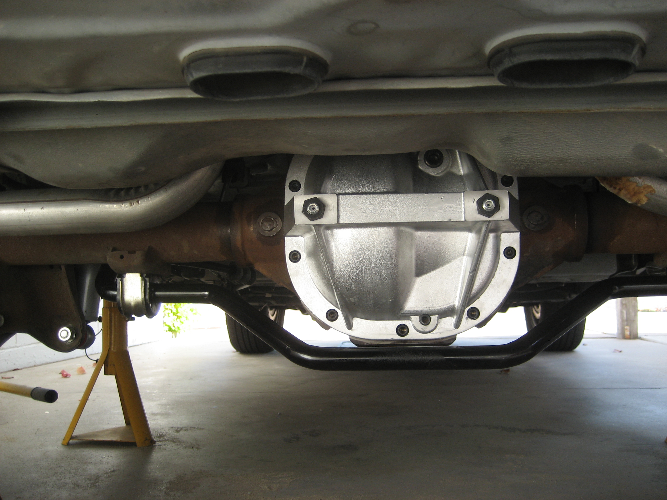

About that differential --
For proper differential service, the differential cover must be removed so that the inside of the housing can be cleaned thoroughly and the internal parts can be inspected for wear and/or damage.
Get a "LubeLocker" Gasket for the Ford 8.8-in. differential -- Part number = LLR-F880 FORD -- I got mine from Amazon.com
The LubeLocker gasket is made in USA of steel -- covered on both sides with rubber, and an elastomeric sealant that is applied at the factory.
NO RTV SEALER of any kind is necessary !!
Clean the mating surfaces carefully, clean your diff cover and put it back on.
When replacing the stock diff cover, it will take 60 ounces of gear oil to bring it to the proper level. The diff cover in the enclosed picture requires 80 ounces of gear oil.
Fill the differential with 75-90 Synthetic gear lube -- I use Mobil 1 75-90 LS or Royal Purple 75-90 --with NO additives.
