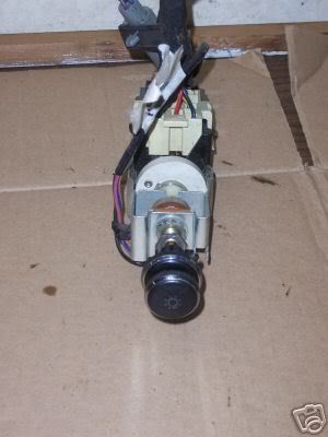

You can also turn on the auto lamps(little turn dial behind pull light switch).
As far as im aware they all have this just turn on and set to the farthest it will go without turning off(little stop) and when the car is on lights are on, when the car is turned off they turn off in 5-10 seconds depending on where its set.
In the Pciture its the little dial behind the pull ****.
-cheers and goodluckEdited by: 92mercmadman
