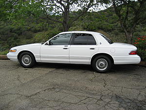

You're good to go for another 35,000 miles ! !
With decent care and maintenance, your Merc should perform well for many more years.
I bought the 95 MERC in 2005 -- @ 51,000 miles.
It now has 157,500 on the clock, and runs beautifully, easily passing our emissions testing with flying colors.
Best of luck with your "new" Mercury.
