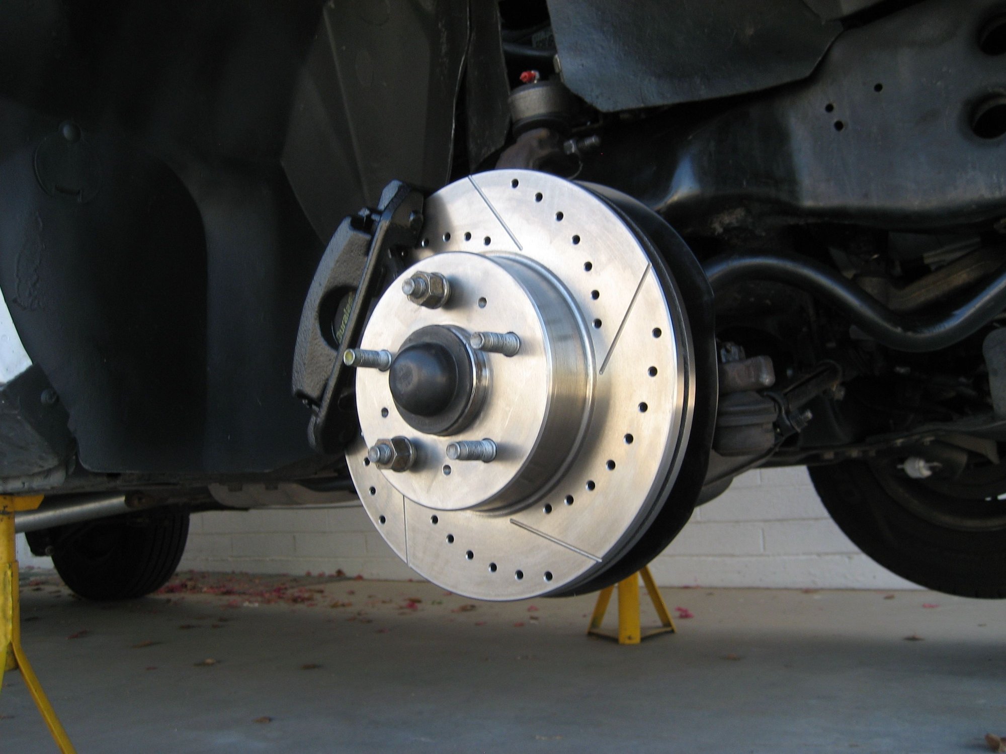

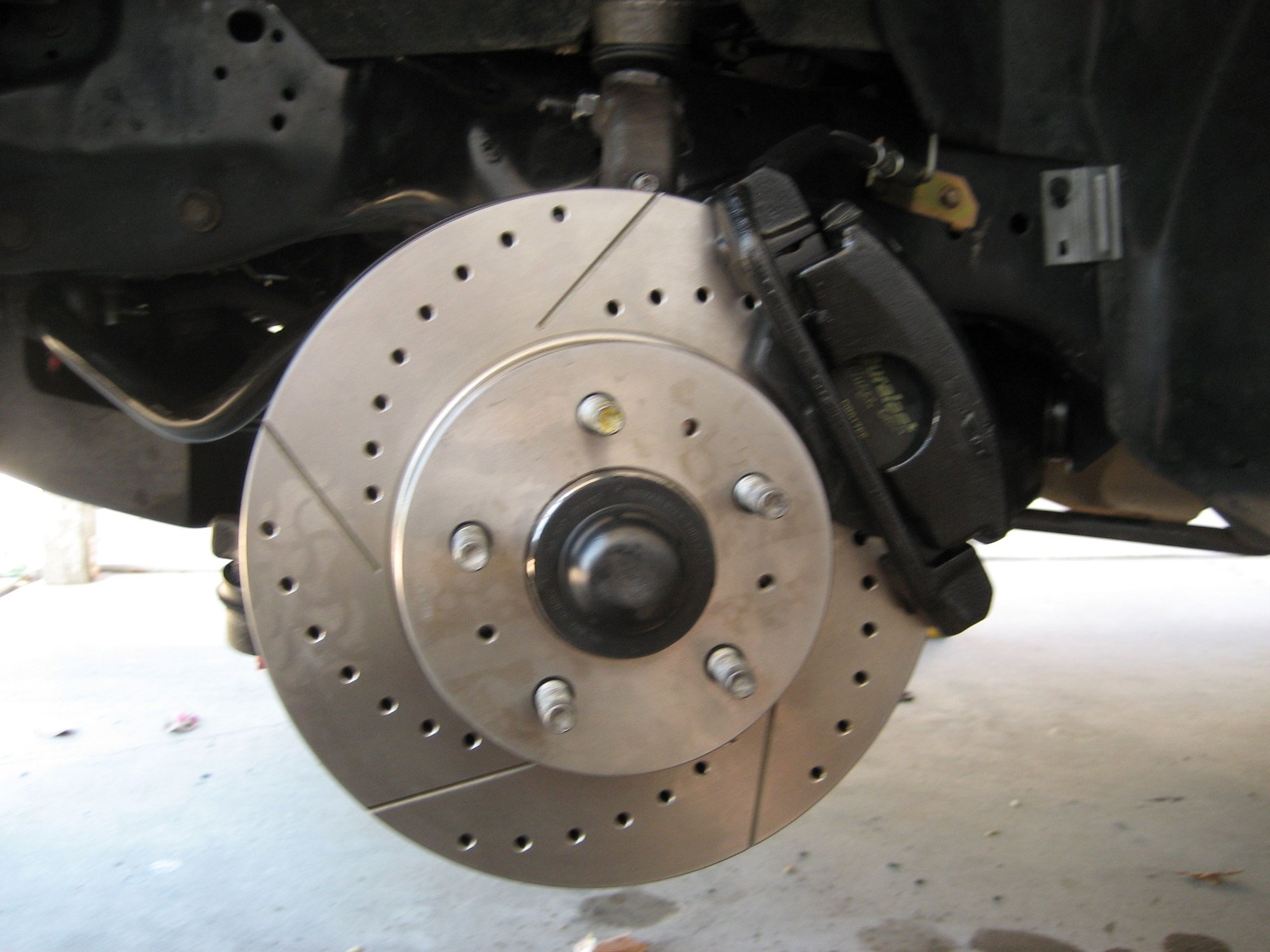

That PowerStop Brake Kit should work out well. I suggest you replace all 4 Brake Hoses and switch to D.O.T. 4 Brake Fluid.
The hoses weaken with age, and a new set will give better "pedal feel", and more confident braking action.
I replaced all brake calipers with NAPA Eclipse units.
Walker H-Pipe; MagnFlw Glasspacks
Front Brakes - Eclipse Calipers; Motorcraft Police Pads; ACDelco Rotors; Centric Hoses; DOT 4 Brake Fluid
Dual exhausts are a MUST, but NO HEADERS !! The high heat from the headers tends to fry the engine compartment, and everything in there ;>)
I used a Walker H-pipe, 2-inch OD MagnaFlow Glasspacks, and Walker tailpipes, with 2.5-inch, slant-cut tips. All exhaust parts bought from Amazon.com,
and welded up at MufflerMasters of Avondale, AZ.

I need to return to exhaust shop again today.... at idle something is bumping against the undercarriage.
Where can I get new brake hoses????? I really wanted the stainless braided but can't find a place that makes hoses for this car.

Forget the braided brake hoses -- not for the Merc G M -- WAAYY too expensive to custom-make.
I used Centric brand hoses, but here is a better choice:
RAYBESTOS Brake Hoses -
Right Front --BH382468
Left Front - - BH382469
Right Rear -- BH382482
Left Rear -- BH382483
Available@ RockAuto.com -- about $20 each
Transmission Shift Kit --
I installed a B&M kit, but now there is a better-engineered product:
TRANSGO -- TRG-AODE-HD2 -- fits '91-'08 AODE/4R70W
Available @SUMMITRacing.com -- about $90 + S&H.
