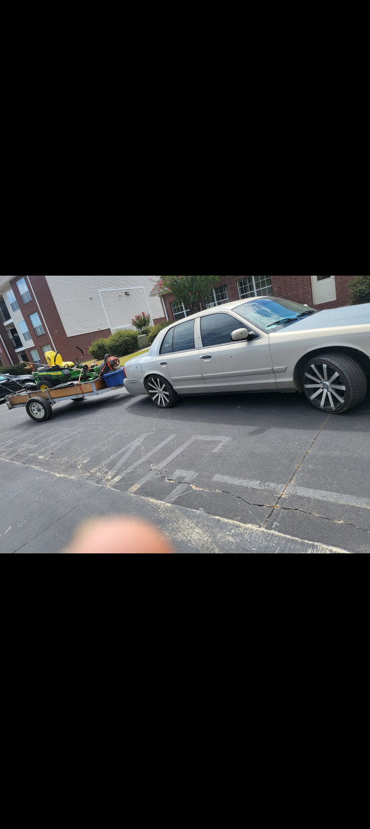

I wired my trailer lights directly to my tail lights/ blinker lights. When I installed my hitched I used some bolts that were previously already in the frame. Been using it for the last two years no problems.
