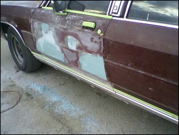

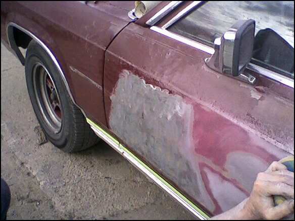

here are pictures... will have plenty more...
look at dent in passenger door... and progress being fixed...

dont worry... the dent wasnt all filled in with bondo...
we used a stud welder to weld studs to the deeper dents, attached slide hammer for my girlfriend to pull steady while i worked out the dent stretching it back into place and getting rid of high spots... all the work was done from outside the door. i got the door pretty much knocked back in shape and only used the bondo stuff for filling the smaller stuff where metal quite wasnt right. personally, i dont think it looks too bad trying to mess with the bodyline was a pain though...

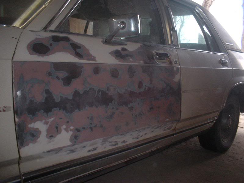

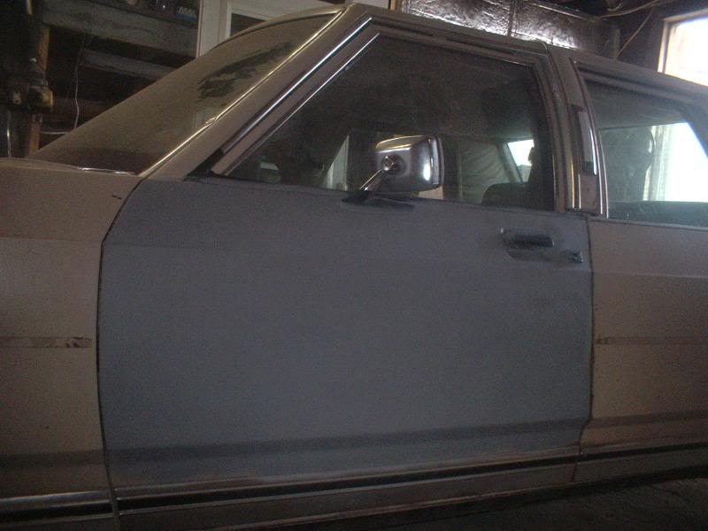

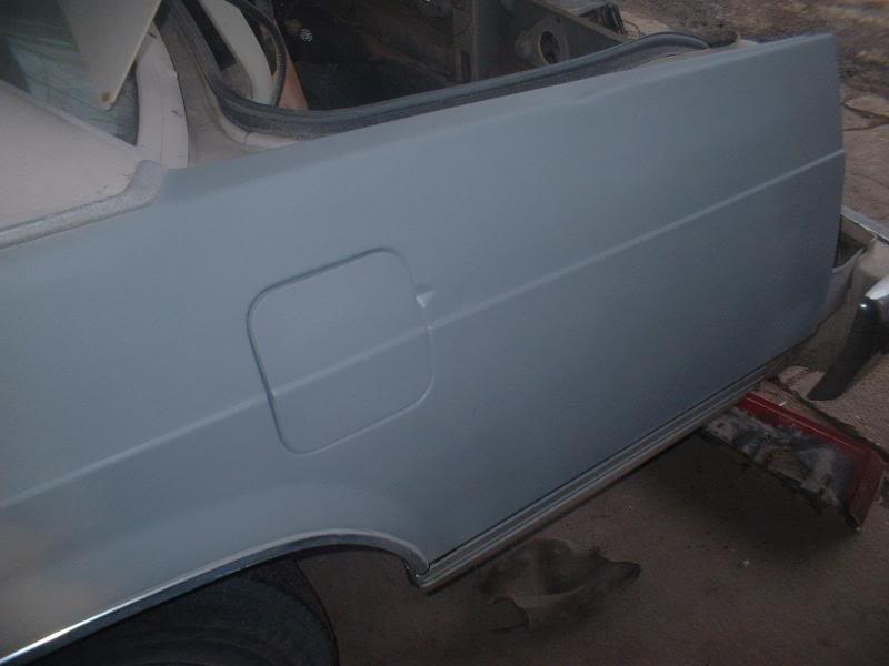

here are more pictures of the driver door and driver rear quarter.... i need to get a picture of driver door primed... it got dark out and unable for photo opportunity.

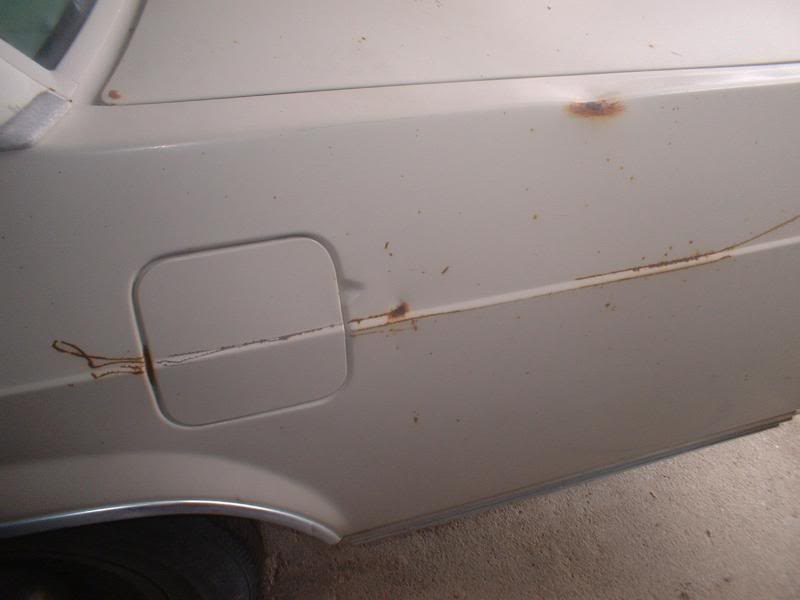

here are pictures of the progress on my Grand Marquis... forgot that i took some and didnt post ...
