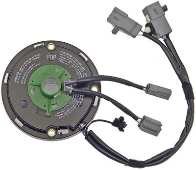

A code six, six flashes means it is the driver side air bag circuit reading open or high resistance. It is the air bag sliding contact assembly (clockspring as it is called). To get an idea what you are looking for the picture below is a Dorman air bag clockspring replacement part. Parts Geek carries them and usually cost around sixty dollars. I would check all the connectors, examine the wiring and such for good connection etc. first before replacing. Replacement involves removing the air bag and steering wheel to get to the clockspring. I think Ford issued a TSB (Trouble Service Bulletin) or something on this.

I saw that in my resaerch and it was the first thing I did,,,,replaced the clockspring and it was a pain in the ***. No change. Still blinking......6 times, 6 times, 6 times....I'd be scared but, 6 times, 6 times, 6 times, 6 times......

1) Was the clockspring you put in new? When there is a poor connection where the clockspring connects into the main wiring harness, an open circuit or high resistance in the clockspring module occurs.
