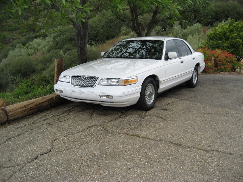

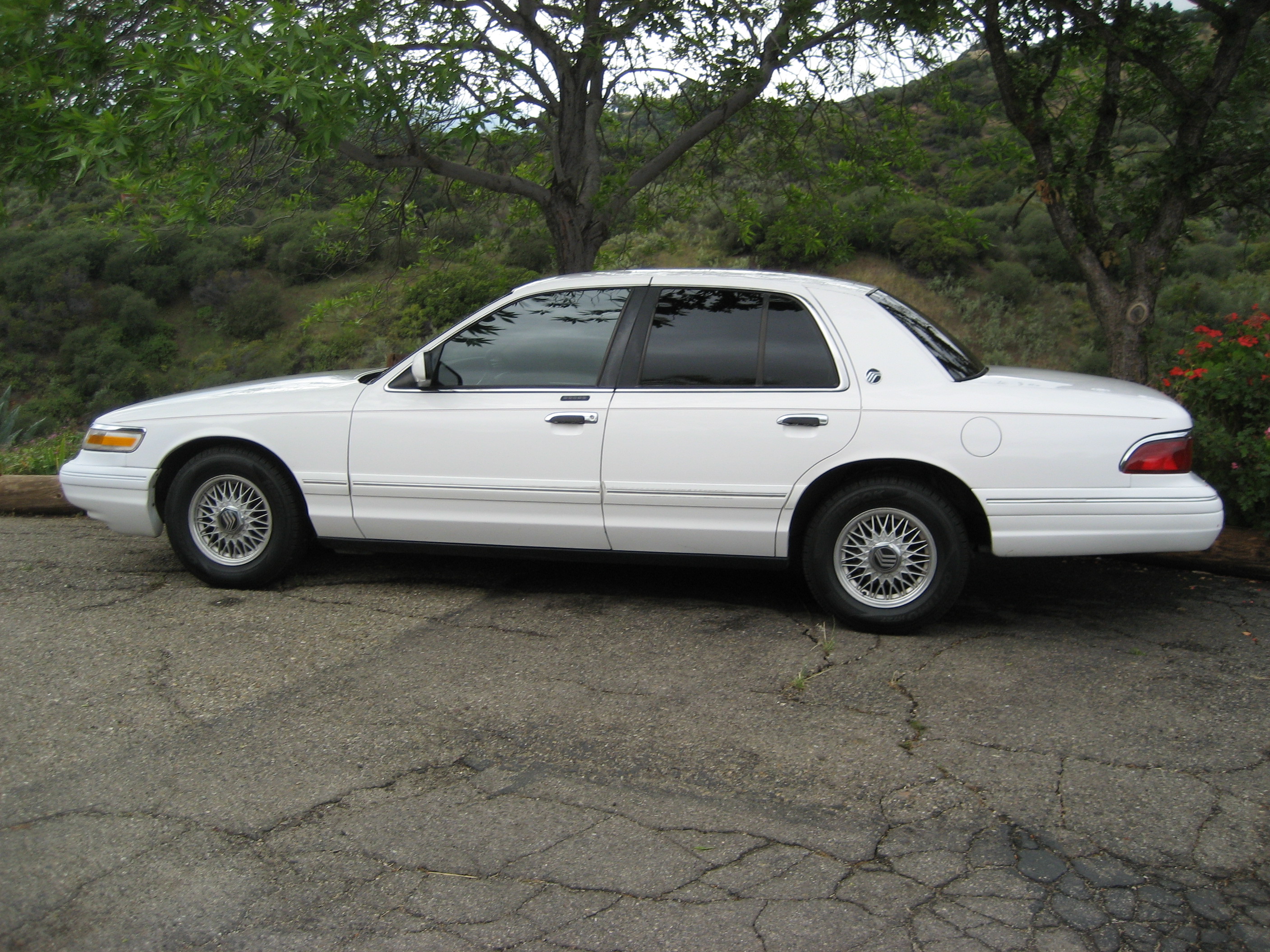

Photos show 1995 Grand Marquis with wheels from a '92 Crown Vic. The '92 Crown Vic wheels are 15-inch diameter x 6.5 inch width x 4.5 inch bolt pattern.
The cast-aluminum wheels are made in Italy. I swapped out the Crown Vic center caps for Grand Marquis center caps. I got a spare aluminum wheel from a junk yard to mount the spare tire.
It's getting hard to find quality tires for the 15-inch wheels, so I wanna find some Mercury 17 x 7s that fit.
