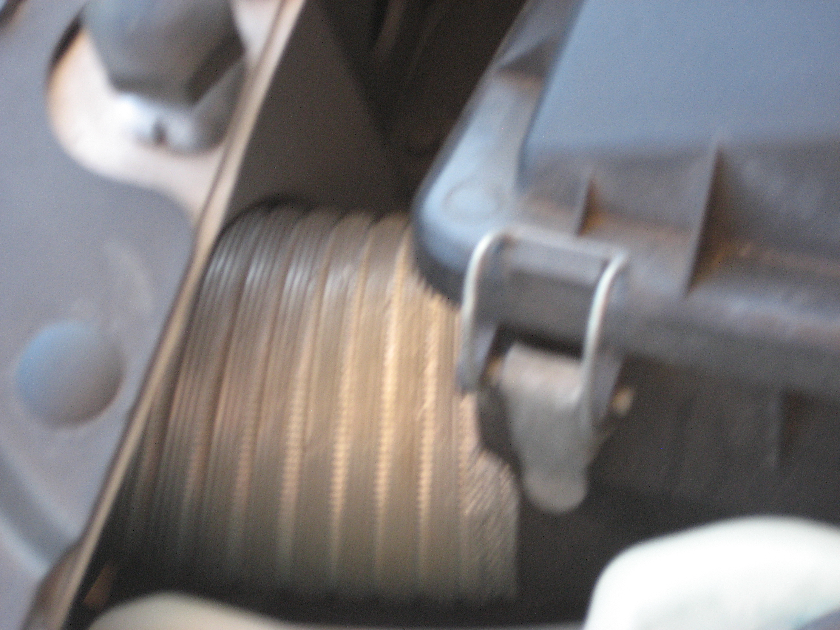

I saved a lot of time and money on the so-called "cold air intake" fad.
On 1995 Grand Marquis, but also works on many other years of Crown Vics and Grand Marquis :
1.- Un-latch the top of the stock air box and remove the filter.
2.- Remove the air box from the fender liner.
3.- Remove the "snorkel" from the air box. The snorkel is 1.75 in. Inside Diameter - you CANNOT get much air thru that tiny opening !!
4.- Add a piece of 3-inch I.D. flexible aluminum clothes dryer hose to extend from the air box, forward to the hole in the radiator support.
5. While the air box is open, clean the MAF sensor, using CRC Mass Air Flow Sensor Cleaner.
6.- Cut a piece of 1/4th-inch Hardware Cloth to fit over the hole in the radiator support -- keeps out low-flying birds.
7.- Put it all back together, using a new (or PROPERLY cleaned and oiled) K&N filter.
You are NOW ducting cooler air from forward of the hot engine compartment, without all the noise.

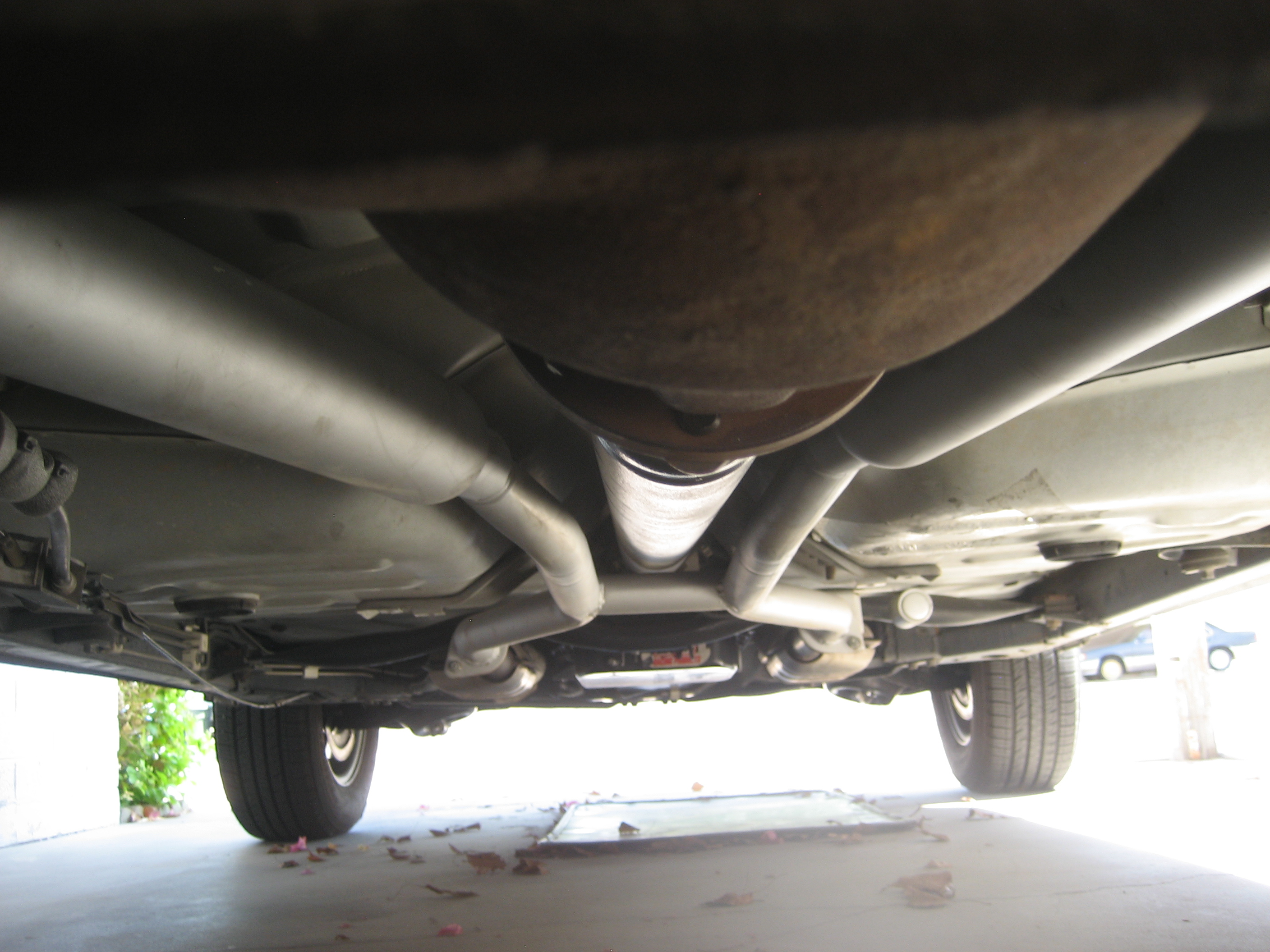

Dual Exhaust - Walker H-Pipe, 2" MagnaFlow Glasspacs, Walker Tailpipes.
