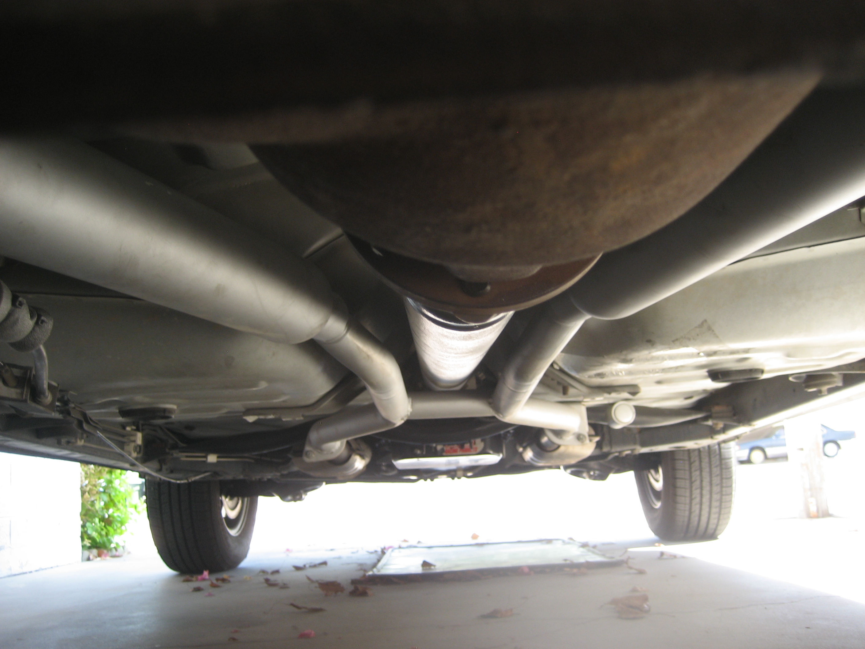

Here's a pic of the dual exhausts on the 95 MERC;
Walker H-Pipe; MagnaFlow Glasspax; Walker Tailpipes.
I got all of the parts at Amazon.com -- Installed the H-Pipe myself,
then had the rest welded up at MufflerMasters, Avondale, AZ.
Strong rumble, smooth tone; no droning.
