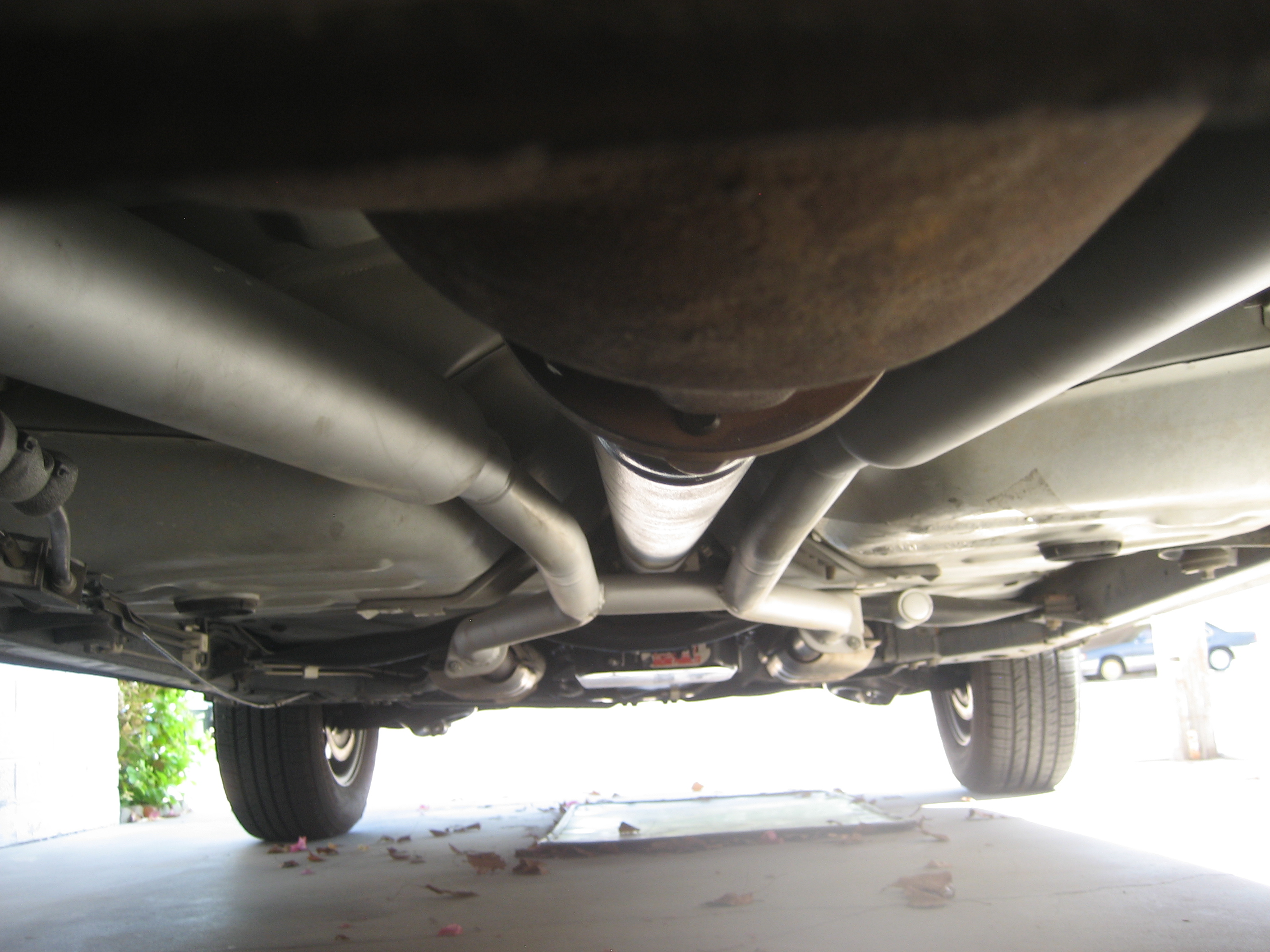

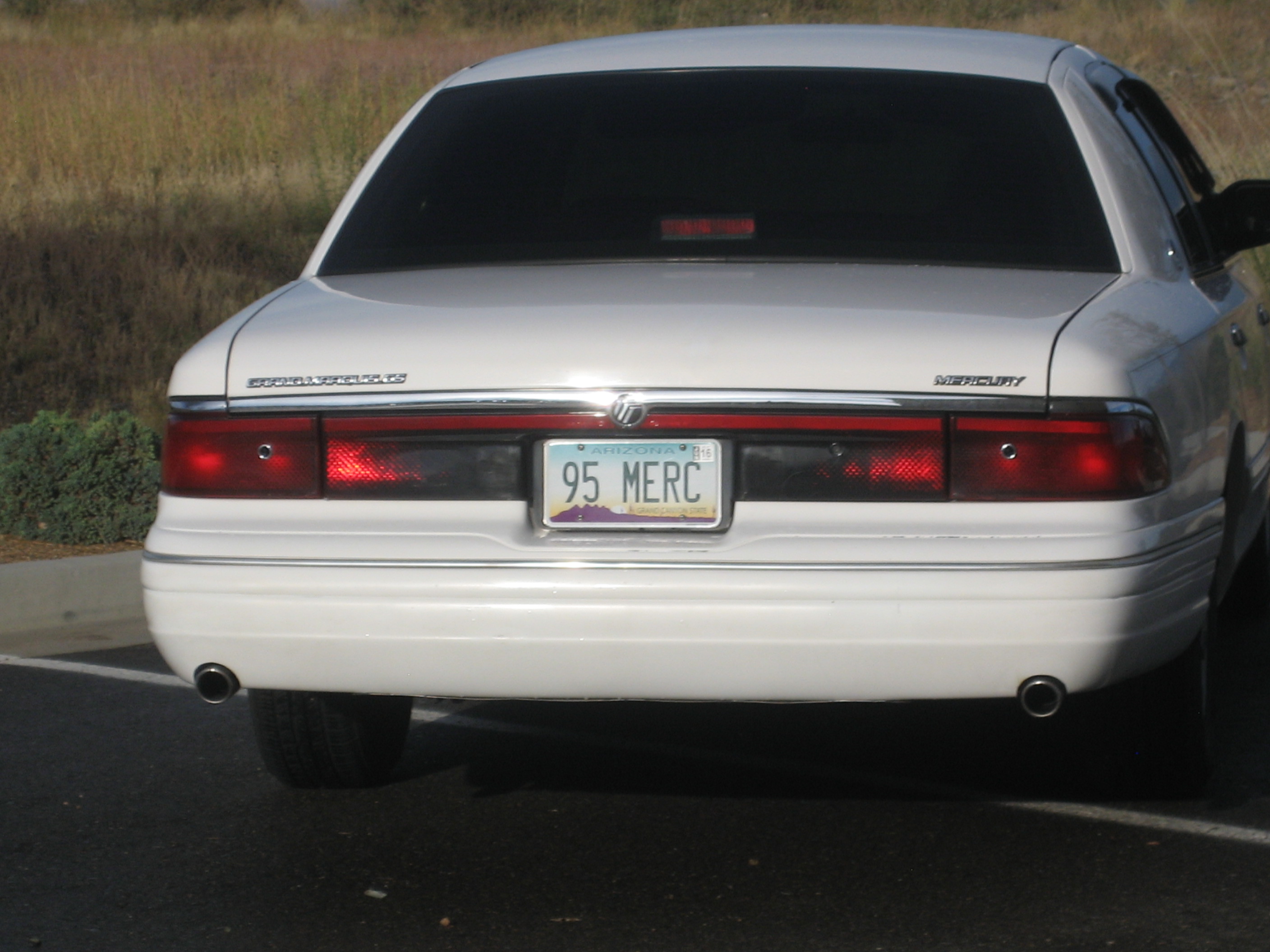

NO, I don't work for or sell MagnaFlow mufflers -- but I run a pair of them on my '95 Grand Marquis Restoration. I'm very satisfied with the sound, performance, and economy.
Photos show dual exhaust: Walker H-pipe; MagnaFlow 2" glasspacks (#18134); Walker Tailpipes; Stainless steel, slant-cut tips.
