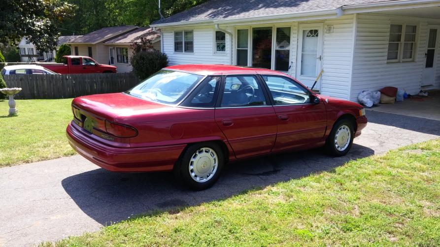

OK, I figured my seat issue out but now I have another.
When I am driving car, it normally takes off like a rocket. It has the 3.8 with 70k original miles. After driving around for a few miles when I go to hit the gas to pass, the car doesn't go. It doesn't stall or misfire, it just hits a dead spot. If you then stop and take off very slow, you can get back up to speeds of like 55 and over. So far, I have done plugs, wires, cap, rotor, cleaned the EGR valve, cleaned the Idle Air Control Valve too. I also cleaned throttle body. The idling has improved somewhat but not as normal as I like. It never stalls. I was told there was a new fuel pump put in car and injector cleaning. I see a lot of Cobb webs on tank so not sure if the guy was BS'ing me or not.
So, any suggestions?
Thanks!
