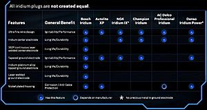

The correct spark plug for your '03 Marquis is the BOSCH Double-Iridium -- Bosch part # 9606
DO NOT use any type of anti-seize compound -- lube the plug's threads with synthetic motor oil ONLY !!
Use a torque wrench to install -- at 12 ft/lbs = 145 inch/lbs.
Best price for these plugs is at RockAuto.com.
